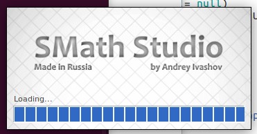

New test version prepared: http://smath.com/file/UMobd
  • Loading splash screen layout fixed:
  • Work with images fixed (save/open files with images, image regions copy/paste, background images)
  • Dark OS theme supported now (not all toolbox icons are vectorized yet - this is test version);

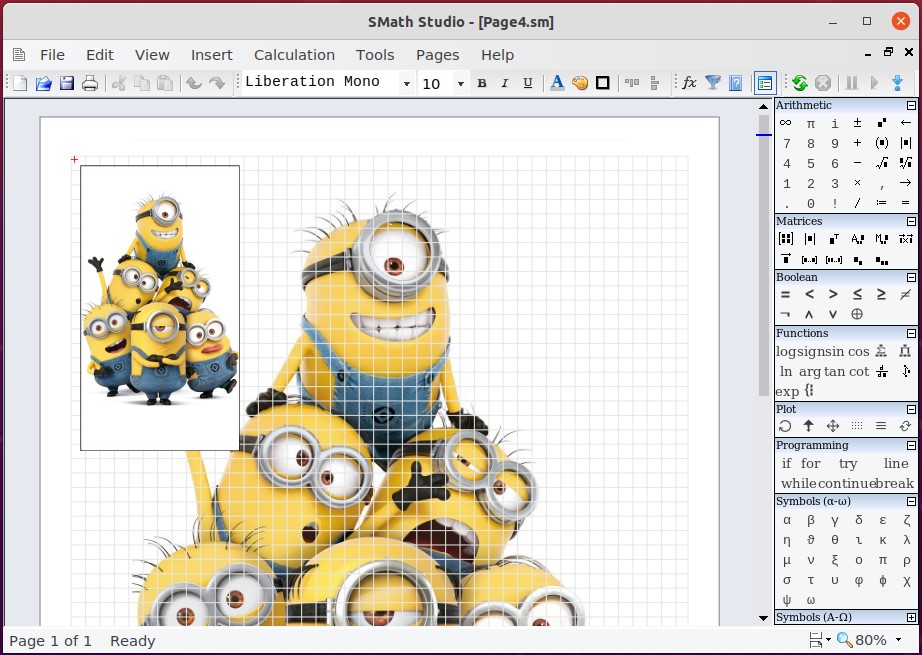

Hi, it's working for me. Thanks!
#15 已发布: 2020/10/23 11:34:58
600个赞,共1,381个帖子。
All is good here, dragging picture from file managers works too.
Thank you Andrey for quick response.

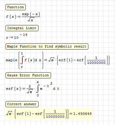

By the way, the calculation you have sent is a Gauss Error Function. erf()
Apparently SMath don't have it yet but you can implement it easily.
Maybe Andrey will add erf() someday, who knows.
I have calculated this on windows. Maple don't work on linux, yet.
Thanks for checking latest SS
Erf(x) is built-in since at least SS 5346 erf(1) from f(x) menu
erf(x) is a monkey business approximation [Mathematica]
But works well in Smath, presumably all versions.
Maths erf(x).sm (32.6 KiB)已下载 1476 次。

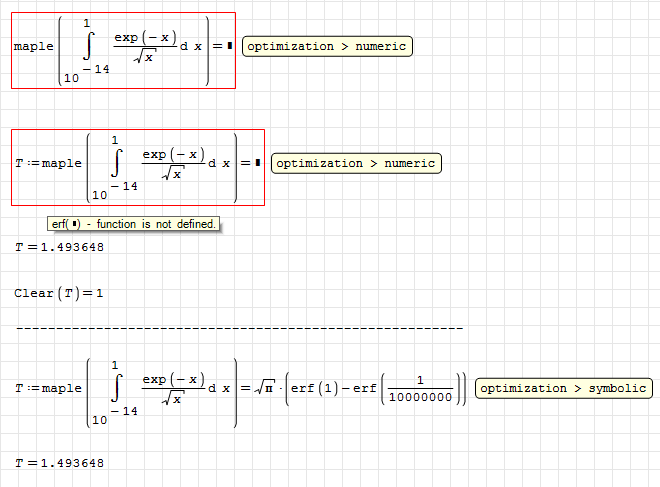

erf() is not built-in to SMath, I have checked.
It is a function of Statistical Tools plugin.
That plugin was not installed on my setup.
I have installed the Statistical Tools plugin to get erf().
It works but still gives "erf() function is not defined" error with maple.
Numeric optimization is causing this when I try to get a numeric result.
However it is calculating the expression and giving the result assigned to a variable, even with numeric optimization.
No issues with symbolic optimization I guess.
Odd behavior.
