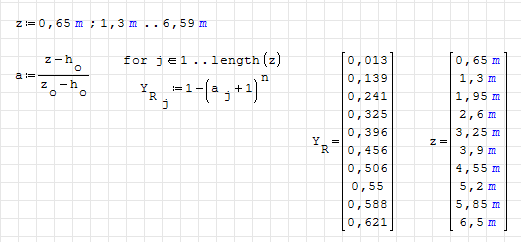

Hello Berk,
To accomplish you task you have to loop through the values of the input vector; to do this you can use the function vectorize(...) or a loop (for(...), while(...));
vectorize:
loop:

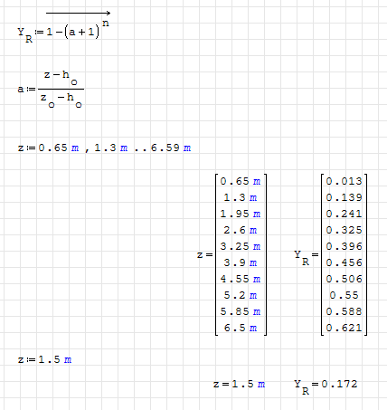

Just like this:
Berk Koç 2016/8/25 02:40:00

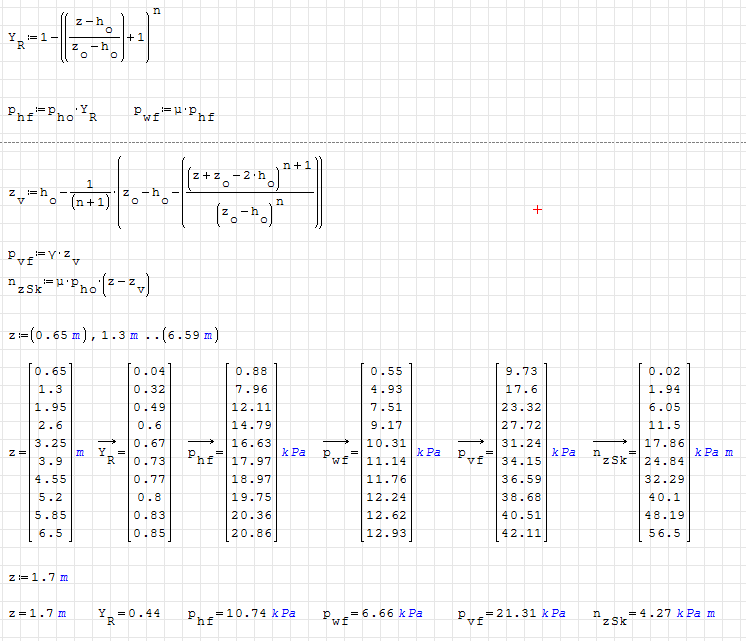

I have done this calculations by vectorize function. I need random value in this equation. For example I need YR at z 1,5 m. How can I get that value to be used in a different equation?

There are several ways:
  • define again a or z, define again Y.R
  • define Y.R as a function: Y.R(a) or Y.R(z)
  • define Y.R before defining z or a -> each time you call Y.R, the last value you define for these parameters will be used
    2016-08-25 16_07_23-SMath Studio Desktop (ver. 0.98.6060) - [en%201991-4(1).sm_].png

This should works:
en%201991-4(3).sm (596.43 KiB)已下载 1409 次。
BTW, it is even possible to move the vectorize() function from the definition to the point where you need to use it

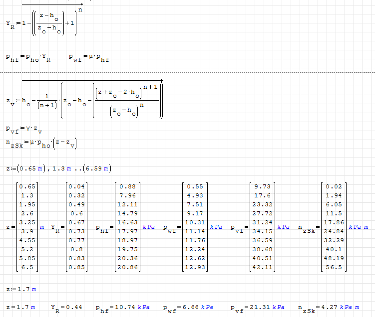

Berk,
that's because of the order of declarations in your file. Please notice that Davide defined formulas first, and later defined the variables that constitute the formulas. This way, when the formulas were defined, the meaning of its constituents was undefined, so it stayed as is: names. When later below, after all variables were set, you tried to get the Y.R value, SMath took the formula for Y.R, substituted all variables in it with their already-known values, and gave you the result for this set of values. After that, you re-defined some of variables, tried to get answer, and SMath repeated substitution in the formula, giving you the new answer.
But in your file, you define variables first, then define formula for Y.R. This way, at the Y.R definition, SMath already knows all variable values, so it stores them in the Y.R definition instead of their names. All later modifications of those variables won't have impact on what is inside the Y.R, so you won't see new results.
But you may use functional syntax instead, something like
Y.R(z):vectorize(1-(({z-h.o}/{z.o-h.o})+1)^n)
, to be independent on the declarations order.

Thank you mikekaganski,
I am really confused because same things on the mathcad program works without any problem.
I have tried what you said in the attached file. I have put z range below the formulas. And I have created function of z with same variable ( both formulas are on the sheet now). But it couldn't calculate the results now with range.en 1991-4 (z).sm (602.6 KiB)已下载 1283 次。

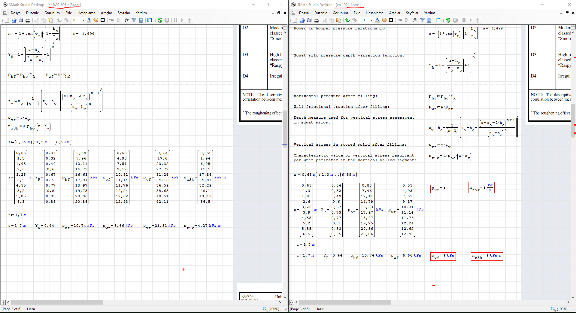

Thank you again, I just wanted to clarify that Y.r was just for demo. To try two methods simultenously. I have written that it is now working on my home notebook but I behave to early.
I have put two files tiled and screenshoted. As you can see all the things are same for both files (left is yours). But mine is not computing. I have just written the explanations of the variables only.
But I am really exhausted. I can't figure it. When I say "ok" now finally, then other issue appears on other place. I thank the author for this program as it is free and capable, I think I am not able to use it efficiently. I started to copy all the text and formulas to mathcad again which is a time consuming process but I can't find any other better way unfortunately.
Please see the attached 1 and 2.png sequentially and 3 and 4.png sequentially. As I understand from numeric, I entered "n" manually after knew the result, then it worked. All the calculations were done and there were no error. The expression at the bottom were ok. Then I deleted "z" value at top of the sheet which was entered to do a trial to see results. Then at the bottom, latests equations gave error.
I tried in another sheet with Y.R(z), it was good at beginning but then it gave an error again when the equations arise.
未找到文件。未找到文件。 未找到文件。未找到文件。

Without this version of the file my best guess is you are feeding the tension with a vector, probably because p.he is involved and is defined after the first assignment of z -> you must move that definition before the first definition of z (another way could be to use Clear(z) from CustomFunction before p.he definition)
Please note, this is an important feature of SMath Studio:
if the dependancy from a variable is hidden (not a function or the variable is not an argument of the function)
  • if this variable is already defined, his value will be replaced and stored in the definition
  • if the variable is not yet defined, the variable name will be stored
See the attachment for simple examples: name value.sm (9.22 KiB)已下载 1283 次。
