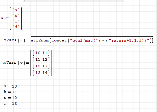

#5 已发布: 2023/7/7 23:52:52
600个赞,共1,381个帖子。
Thanks, unfortunately value to be assigned is supposed to come from somewhere else, z was just an example because I didn't want to make example with large vectors or matrices to be assigned.
Something like this?
z can be anything and come from anywhere.
As long as it has same length with v.
StrAssign.sm (6.91 KiB)已下载 1432 次。
Click to enlarge
#6 已发布: 2023/7/8 17:48:00
Lupus the Canine
Lupus the Canine
0个赞,共7个帖子。
Thank you for your help makraska and overlord.
This look great. I will throw eval in there to be sure it is numeric assignment.
