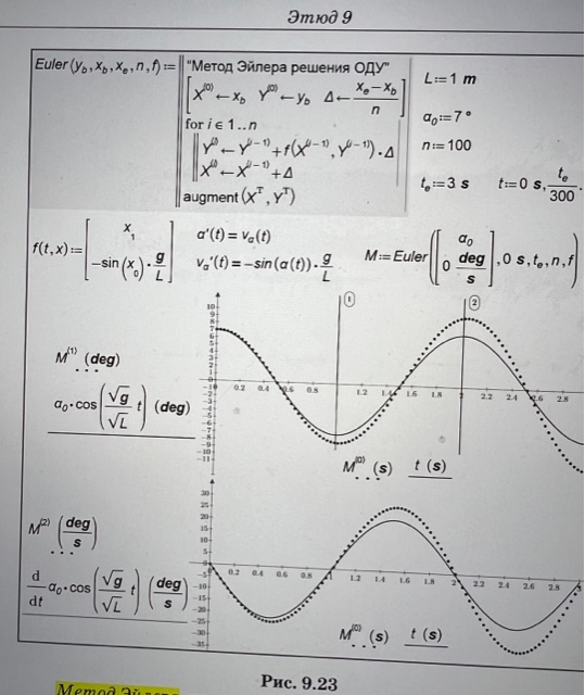

#11 Posted: 2023/4/26 04:32:50
1,106 likes in 1,784 posts.
... And what about the last Mathcad operator?
Matrix handling in SMath is more similar to Matlab than Mathcad.
I need
Click to enlarge
Euler.sm (26.06 KiB) downloaded 1260 time(s).
