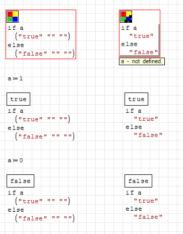

#31 Posted: 9/26/2014 3:26:38 AM
Hello brotjob,
I cannot reproduce (or I've misinterpreted the issue)
I see what is shown in the screenshot
#32 Posted: 9/26/2014 5:01:29 AM
brotjob
brotjob
7 likes in 71 posts.
Hi Davide
First of all it's nice that you don't need the matrices anymore. Is there some kind of documentation of the plugin?
I tried your above left example in a new worksheet->works perfectly. I change a to 1m ->label becomes red. I change if a to if a>0 ->smath crashes
#33 Posted: 9/26/2014 7:42:31 AM
Is a recent feature
The official documentation is attached in the first post, moreover the Activebook of Martin Kraska contains a section for this plugin. Both should be updated, I'll do ASAP.
This is because the if statement doesn't support units as result of the condition argument. This is not in my hands.
I can't reproduce this issue, I'll investigate...
