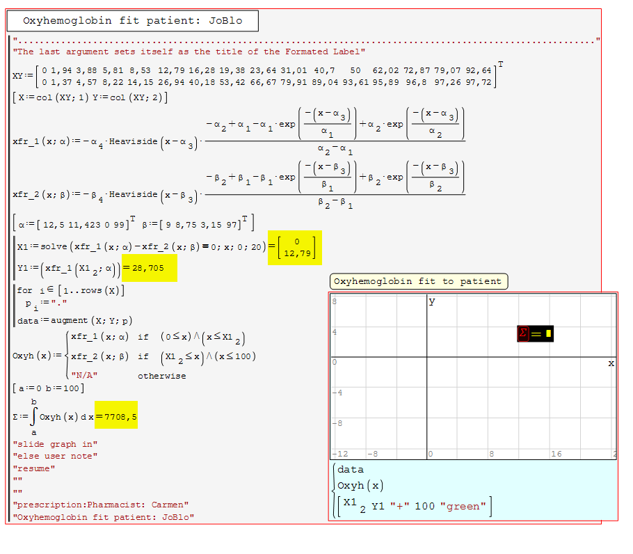

Here it is.
losa-forum.sm (862.11 KiB) downloaded 1930 time(s).

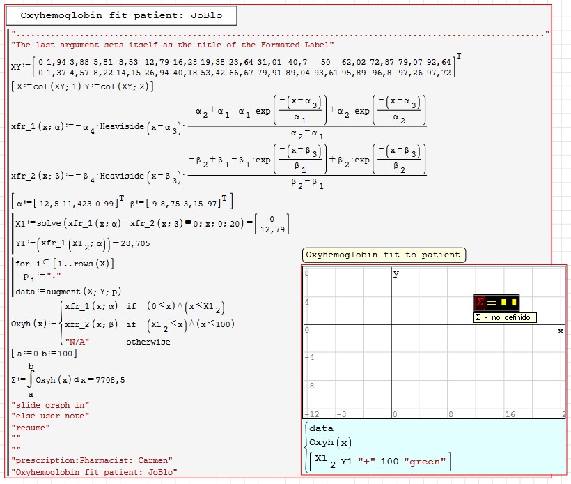

Sorry Jean but i don't understand what i'm supposed to see. I also get "data - not defined".
#82 Posted: 1/17/2023 10:18:15 AM
Sorry Jean but I don't understand what I'm supposed to see. I also get "data - not defined".
data not defined probably indicates some plugins not installed.
Maybe other problems wrt your version.
#83 Posted: 1/17/2023 10:55:42 AM
Here it is.
Document does not open ... incorrect format

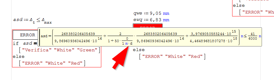

If you hover over the asd definition you can see that there is an unsolved "d" dependancy that triggers the error.
The same happens if you try to force a numerical evaluation using eval()
That is it!
As allways thanks!!
But still don't understand why Jean files fails.

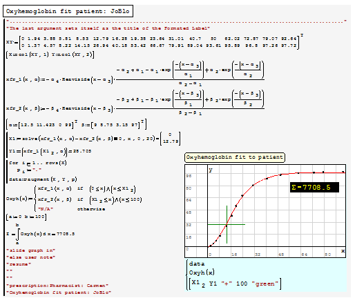

Slide left the Formatted Label
Side right the graph, remove the Σ no definido
You should see the plot.

There is an excel data import at the begin of the file, is not related to the issue however so it doesn't matter. nevermind I was looking at your file.
If you remove the 3 inline evaluations it will work.
2023-01-17 16_28_05-SMath Solver - [Image Formated LABEL [Oxyhemoglobin] FORUM.sm].png

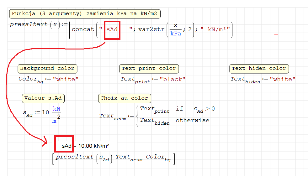

Can we manage the units that are displayed?
I have a load in kN/m2 and the result appears as kg/(m*s2).
The idea is to present only positive values (with the appropriate unit).
kind regards
Conditionally Formatted Labels_unity.sm (5.47 KiB) downloaded 1888 time(s).
#91 Posted: 10/14/2023 11:52:58 PM
The easier way might be something like this
2023-10-14 18_53_23-SMath Solver - [Conditionally Formatted Labels_unity.sm_].png
press2text(x):line(concat(var2str(x/'kPa,1),"\0020\kN\002F\m\00B2\",1,1)

Thank you very much.
This is exactly what I needed.

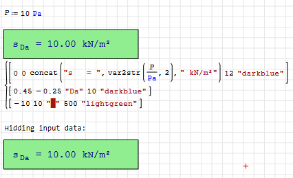

I'm looking for a way to represent the letter D as a subscript. Unfortunately, Unicode doesn't seem to provide this option...
Is there any possibility to parameterize individual characters that will be presented?

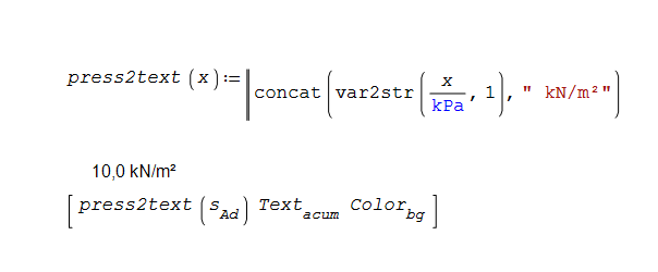

#95 Posted: 10/17/2023 1:32:30 AM
Rogalski
Rogalski
0 likes in 7 posts.
You can subscribe whatever.
mysystem dot HelloGrandMa
thanks for the information, but I'm not sure if I expressed myself correctly. I mean the subscripts in the "phrases" that I marked in the drawing.
Davide sent the function shown above in which I need to use subscripts.
#96 Posted: 10/17/2023 2:13:46 AM
Oscar Campo
Oscar Campo
135 likes in 309 posts.
Davide used superscript unicode character for write: "kN\002F\m\00B2\" wich renders as "kN/m²" so, you can use unicode characters...but not all characters have subscript version.
Please check here: https://www.compart.com/en/unicode/search?q=subscript#characters
Oscar
#97 Posted: 10/17/2023 1:30:37 PM
1,139 likes in 1,805 posts.
Hi Karol. This could be a workaround, using the SMath Plot region.
label.sm (6.22 KiB) downloaded 1864 time(s).
Oscar Campo 10/17/2023 4:52:00 PM
#98 Posted: 10/17/2023 6:15:56 PM
Wow great Alvaro. Thank you very much.
I'm impressed.
