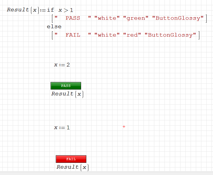

I've really been getting some good use out of this plugin for pass/fail warnings on calcs, but here's a question. I tried using a check mark and X in an if statement in the label, and it displayed correctly in the if statement but not in the result. This was using the Segoe UI Symbol font. First I'd copied and pasted from Windows Character Map and the output was just the unicode number for that symbol. I went to Settings and changed the font to Segoe UI Symbol to see if that would help but it didn't. Is this something that is possible? Thanks!
#67 Posted: 10/14/2020 8:47:18 AM
Thank you Jason, I think that I've missed to implement it in some branch of the code, I'll fix it ASAP.
#68 Posted: 10/14/2020 8:51:03 AM
About CharMap, you have to experiment several up until you get the
appropriate character instead of Unicode.
For direct calculations, Smath error message is sufficient.
You can't really trace from within program, not even Mathcad 11.
Calculations may have passed but so wrong !
#69 Posted: 10/14/2020 12:33:05 PM
Not sure what you are after ?
#70 Posted: 10/14/2020 8:15:48 PM
Just released a fix, it should works now.
sergio 10/15/2020 5:00:00 AM, Jason McCool 10/15/2020 3:48:00 PM
#71 Posted: 10/15/2020 3:53:42 PM
Jason McCool
Jason McCool
9 likes in 78 posts.
Works great now - Thanks!

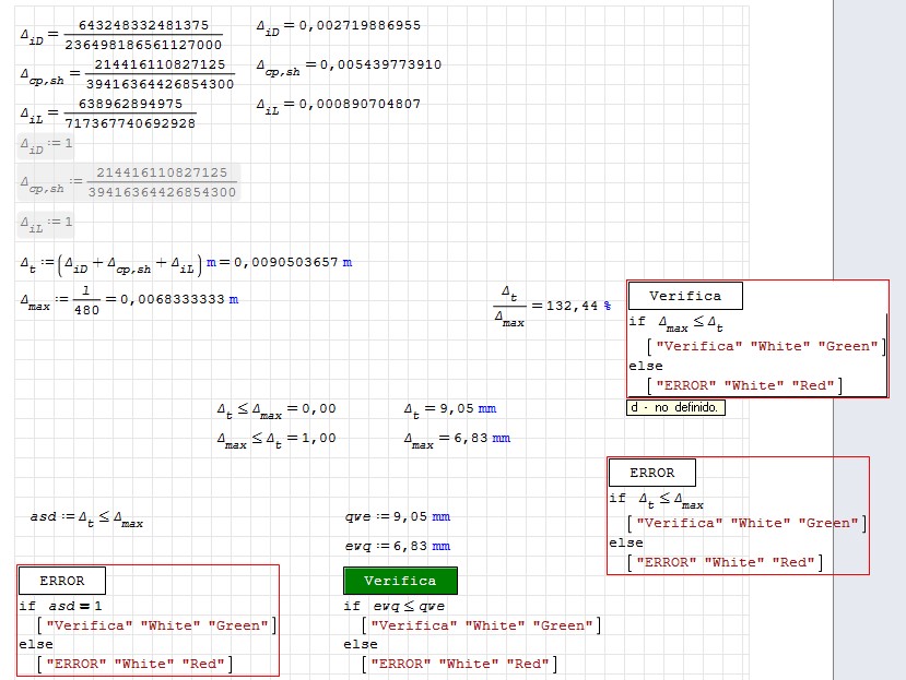

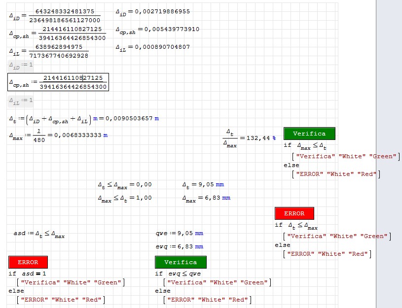

#78 Posted: 1/16/2023 7:21:00 PM
German
German
0 likes in 8 posts.
Hello, i am having problems with this plugin or i dont exactly kown if the problem is the plugin.
I attach images that can explain the situation better than my words.
When i define the same value manually the warning disappears
#79 Posted: 1/17/2023 12:14:36 AM
NDTM Amarasekera
NDTM Amarasekera
130 likes in 352 posts.
Hello. Better if you post the sm file, for anybody to check.
Davide Carpi 1/17/2023 11:21:00 AM
#80 Posted: 1/17/2023 8:42:51 AM
Hello, I am having problems with this plugin or I don't exactly know if the problem is the plugin.
Formatted Label supports conditional, providing set correctly.
Image Formated LABEL [Oxyhemoglobin] FORUM.sm (16.86 KiB) downloaded 1506 time(s).
