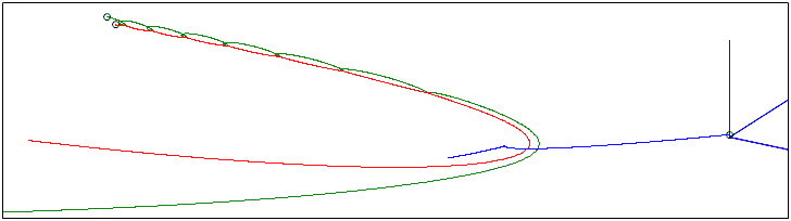

Hi. Very interesting. It could be animated and add z axis. Maybe speed vectors too and the "ecliptic" plane.
3body.sm (37.44 KiB) downloaded 1713 time(s).
Вячеслав Мезенцев 4/2/2023 9:33:00 AM
#144 Posted: 4/2/2023 9:34:42 AM
1,558 likes in 1,868 posts.
It is necessary to choose the conditions of the problem in such a way that the massive body intercepts the satellite.
Hi. Ok.
3body.sm (37.78 KiB) downloaded 1694 time(s).
Вячеслав Мезенцев 4/2/2023 10:22:00 AM, Mark R Harris 4/3/2023 2:32:00 AM

Hi. Ok.
A very witty, funny and clean solution.
Click to enlarge
7-13-Three-Planets 5 (Mathcad Block).sm (26.36 KiB) downloaded 2180 time(s).
7-13-Three-Planets 5 (Mathcad Block).pdf (61.72 KiB) downloaded 1182 time(s).
Alvaro 4/3/2023 6:57:00 AM, Mark R Harris 4/4/2023 4:19:00 PM

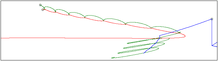

#149 Posted: 4/4/2023 1:59:18 AM
Little bit more.
Click to enlarge
7-13-Three-Planets 6 (Mathcad Block).sm (26.11 KiB) downloaded 2186 time(s).
7-13-Three-Planets 6 (Mathcad Block).pdf (67.28 KiB) downloaded 1039 time(s).

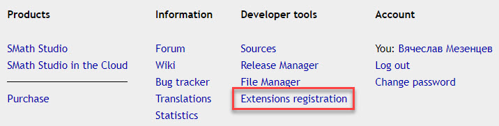

Try to log in here using the registration data in the program: https://en.smath.com/upload/extensions.aspx
You should see this picture:
Click to enlarge
Next, you need to choose the type of extension
Click to enlarge
Before uploading a file, you need to fill in the document properties. Later, you can delete the file if necessary.
Click to enlarge
If the registration data is not suitable, then you need to request them from Andrey via e-mail.
The registered files will be available through the gallery.

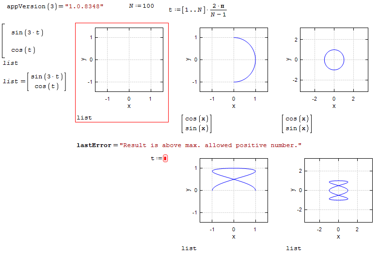

#159 Posted: 4/17/2023 4:43:23 PM
1,361 likes in 2,275 posts.
Unfortunately, I can't reproduce your parametric plot example.
It seems that the parameter range is taken from the x axis limits. Assigning a range to the parameter makes the plot fail.
How to fix this?
BTW, how about making the glyph of the mathcad block reflect the actual type by using {,[ or | to indicate the vertical extension?

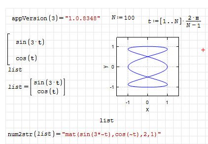

#160 Posted: 4/17/2023 5:22:41 PM
1,139 likes in 1,805 posts.
...How to fix this? ...
Use ~t instead t in list, but t in the range.
