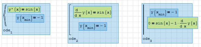

BTW, how about making the glyph of the mathcad block reflect the actual type by using {,[ or | to indicate the vertical extension?
I haven't done this yet because I want the user to be able to choose the type of lines. For all sides.

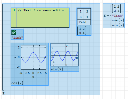

1,558 likes in 1,868 posts.

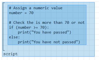

SMath Studio compatibility
Plugin updated.
Changes:
- MathcadBlock: added support for TextRegion.
Click to enlarge
maple-system-python-TextRegion.sm (5.58 KiB) downloaded 1693 time(s).
sergio 4/30/2023 12:37:00 PM, Alvaro 4/30/2023 1:25:00 PM

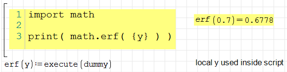

Plugin updated.
Changes:
- MathcadBlock: added support for function definition.
Now the function definition can be written directly in the block.
Click to enlarge
maple-system-execute.sm (8.08 KiB) downloaded 1775 time(s).
Memo Region also supported but it has not been updated for a long time, so some of its text functions do not work.

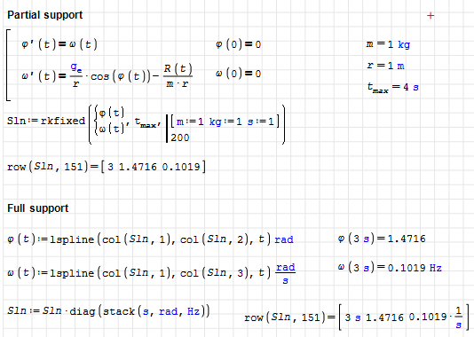

#170 Posted: 11/25/2023 8:25:40 AM
1,361 likes in 2,275 posts.

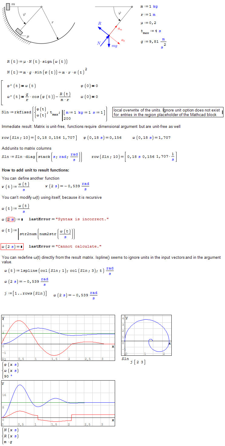

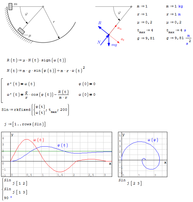

Is there a chance to at least partially use units here? The values with units are disabled in the sheet, this is not visible in the png-file.
7-1.sm (29.01 KiB) downloaded 1734 time(s).
sergio 11/25/2023 7:38:00 PM
#171 Posted: 11/25/2023 1:26:55 PM
1,139 likes in 1,805 posts.
This is an option for having partial and full units support.
7-1-units.sm (35.56 KiB) downloaded 1705 time(s).
sergio 11/25/2023 7:38:00 PM, Martin Kraska 11/25/2023 7:45:00 PM
#172 Posted: 11/25/2023 7:44:24 PM
Alvaro, thanks for the hints.
By whatever reason, the unit of the independent variable is respected in rkfixed()=even though it is set to 1 locally. Whatever locally means if that happens in the last input parameter value.
7-1_units.sm (39.68 KiB) downloaded 1740 time(s).

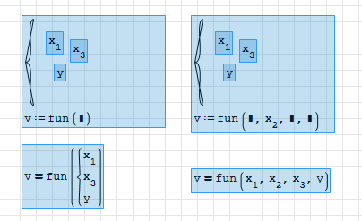

I think it would be fun to add the ability to tell the component where to insert a set of expressions: as the first parameter, as the last parameter, as parameters, as parameters before specified, after specified.
Or to indicate where to place them.
