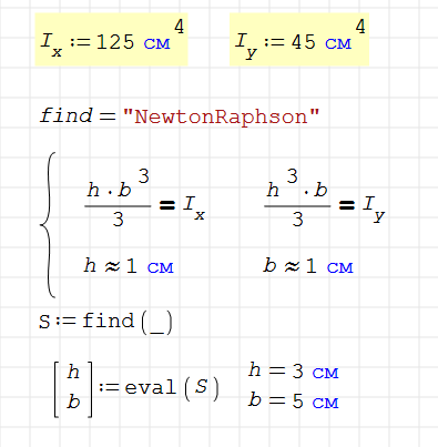

Interesting things are going on, I am really excited!

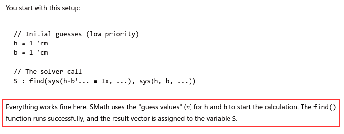

I think that the explanation by Gemini is not entirely correct. Yet, he hint on circularity is helpful.
If that was true, we would not have that circularity problem. Also we would not see the entire find command with it's arguments if we display the stored expression from the find block in the dynamic assistant.
Actually I believe that the find function (like any other function in any assignment does nothing (except for substituting existing definitions from the context) unless a result display is requested. I call this delayed evaluation.
Also, assignment to a variable should not affect anything above the current definition. Backfiring should be limited to absolute variables as sometimes used for iterations with on-the-fly animation.
If Gemini was right here, the simp() function in my above example would not help. simp() actually triggers evaluation because num2str() does so. BTW, in the given case S: eval(S) also does the job.

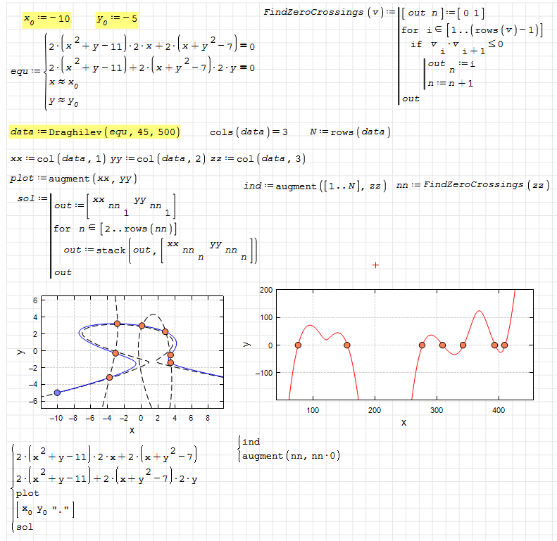

- Draghilev solver added.
This is a very simple implementation.
MathcadToolbox-Draghilev-simple.sm (20.83 KiB) downloaded 1420 time(s).

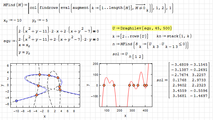

Hi Viacheslav. With a matrix non-zero finder, like the one in Matlab, you can simplify the axis crossing detection.
MathcadToolbox-Draghilev-MFind.sm (30.45 KiB) downloaded 1504 time(s).

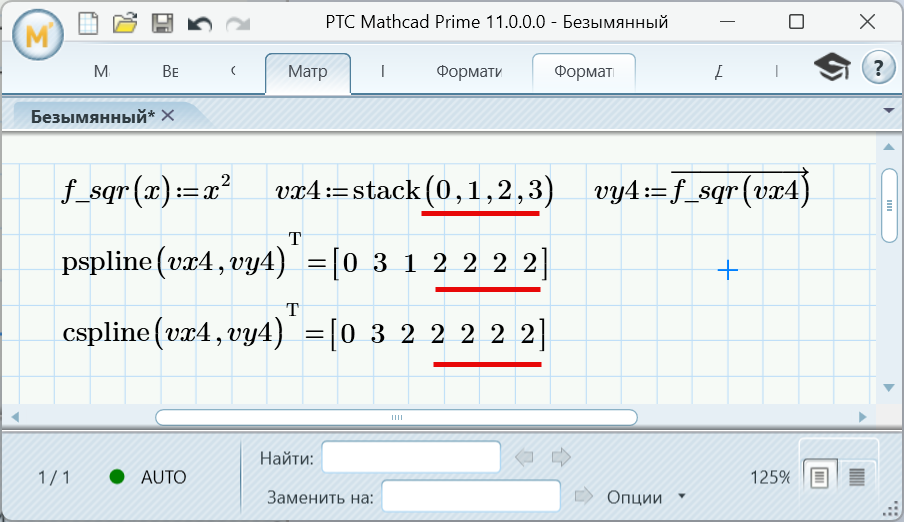

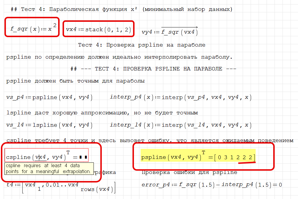

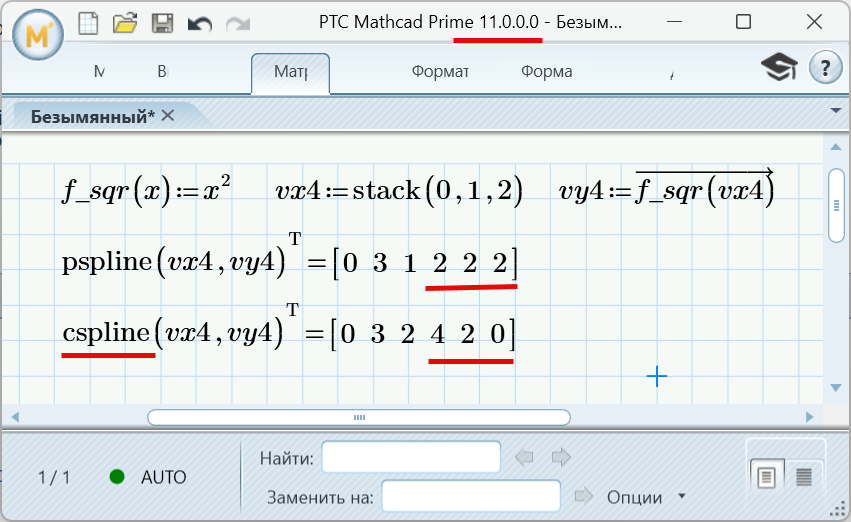

#206 Posted: 8/22/2025 1:37:36 PM
1,558 likes in 1,868 posts.
Quote

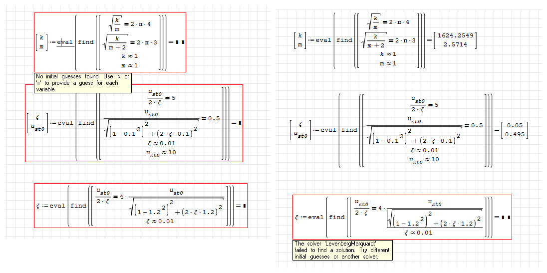

This is demonstrated in the code in the attached file, along with combining the x ≈ a notation with the x = a notation.
You might be interested to know that the find function was written using AI using the nsol function as an example. I have been working with AI for some time and now it can convert almost any description into code.
It understood perfectly what was happening in the nsol code, praised the author and offered the implementation as a find function. Of course, I told it what to do, but basically all the code was written by AI.
All numerical solvers that find() uses are also written by AI in 10 minutes.
The same goes for Draghilev's method, it is also based on your example. It is too complex to understand, but in general I know what is happening there, and for AI there were no difficulties at all.
Now I'm trying to port lsode (odesolve) from C code to c#. It's too huge to be done in one evening and there are many complexities, but the AI ​​said that everything will be fine.
I will later connect all the existing numerical solvers to the find function, and all the numerical differential solvers to odesolve. In particular, it will learn to classify a problem by a set of equations and select an appropriate solver.
Unfortunately, when working with the AI, you need less time, but more knowledge. Not everything it offers corresponds to my level as a programmer.
AI also helped to understand splines. It found an inaccuracy in the Mathcad.
Edited 8/22/2025 2:01:39 PM

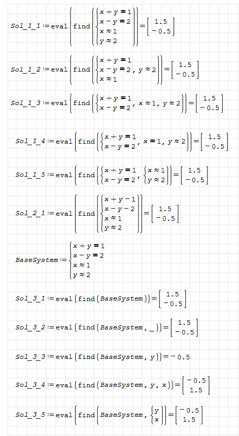

- find() function syntax extended.

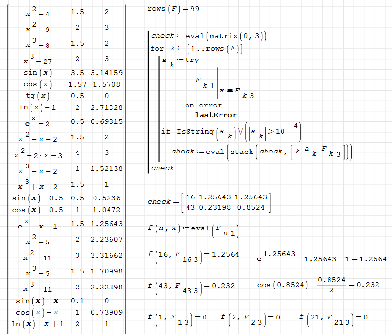

#209 Posted: 8/24/2025 5:49:38 AM
1,139 likes in 1,805 posts.

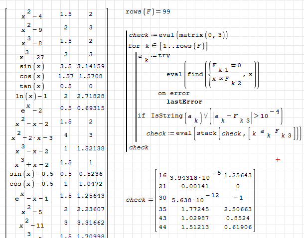

Hi Viacheslav. You also can ask the IA for matrices with known examples to check the answers. In this case, one variable function, the guess and the root.
check-find.sm (37.51 KiB) downloaded 1349 time(s).

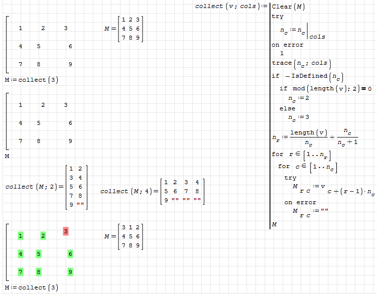

#211 Posted: 8/24/2025 2:55:32 PM
1,361 likes in 2,275 posts.
Mathcad block for entering matrices. This allows for inserting and deleting rows and columns using ordinary SMath edit. Each entry is a formula cell.
Problem is that it is easy to get the wrong sequence by slightly misplacing entries.
Also, it is not nice that the procedure can't guess the shape of the matrix from the arrangement of the entries.
collect.sm (14.9 KiB) downloaded 1375 time(s).
francesco rapuano 8/24/2025 3:02:57 PM, Alvaro 8/25/2025 6:21:19 AM
#212 Posted: 8/24/2025 3:08:34 PM
You can also try it this way
Alvaro 8/25/2025 6:21:12 AM, Martin Kraska 8/24/2025 4:05:35 PM

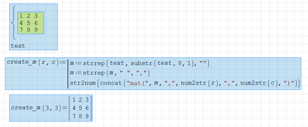

#213 Posted: 8/25/2025 6:45:40 AM
Hi, I see you're using the character at position 8 to find the newline. The text inside the mathcad block uses a different character than the one used in the text inside a description(). One way to get both is this (Carriage Return & Line Feed)
You can then handle text from both the mathcad block and description(), for example, using strrep(text,'CR,'LF)
Edited 8/25/2025 6:46:29 AM
Вячеслав Мезенцев 8/25/2025 6:59:03 AM

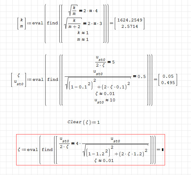

Smath v1.3.0.9126, MathCad Toolbox v0.6.9367
These equations used to work in the original document, but today they all show red. Then I copy them and paste them to a new blank document, the 1st and 2nd equ works except 3rd one.

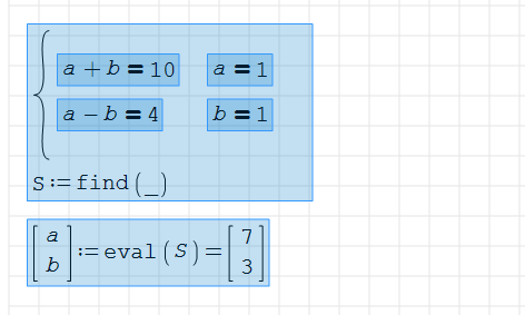

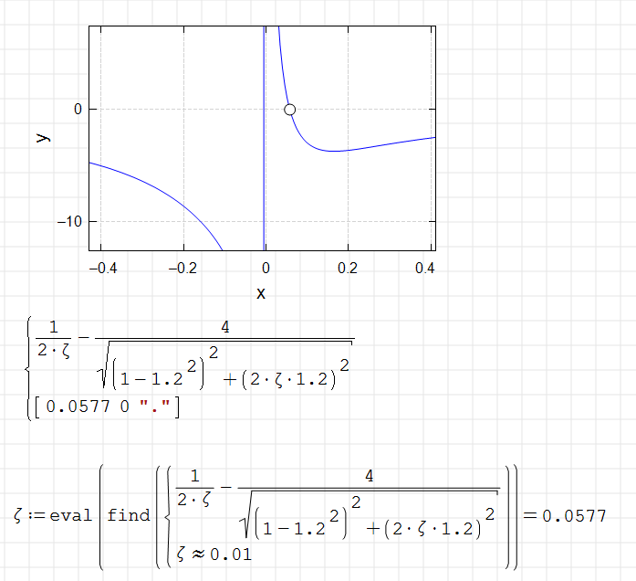

This is the basic form of using the find() function.
All other methods should be used after mastering the basic ones.

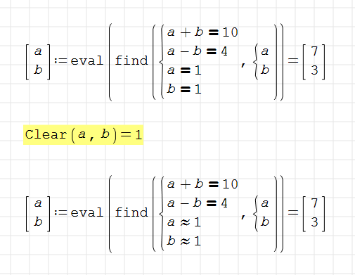

use Clear() function between 2nd and 3rd equations and evaluate:
When this function is evaluated, the value of arguments in the function are cleaned.
Oscar

#218 Posted: 9/1/2025 6:25:38 AM
Try this

Hi. Usually, isn't easy verify the calculus from a picture, it's better from the source. You use ":=", instead "=", as Oscar suggest.

Pay attention to this convention:
When you type ":" in SMath, you are assigneing a value to a variable and SMath renders as: ":=" .
When you type "=", you are asking for the value of a variable, or evaluating a function, and smath renders it as: "="
In your case, Clear() is a function, so, when you type "Clear(z[Ctrl+g]):1" which renders:
Here you must to type "1" and you are assigning the value "1" to "Clear(zeta)" . This is wrong.
The correct syntaxis to evaluate the function Clear() is : "Clear(z[Ctrl+g])=" which renders:
Here you don't type "1". The value "1" is an automatic response to evaluation of the function Clear(). It is the boolean answer of successfully having evaluated the Clear() function
