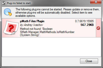

uMath Files Plugin appears to be broken with new release.
#3 Опубликовано: 13.03.2018 14:58:12
2 343 сообщений из 4 044 понравились пользователям.
Группа: Super Administrator
Thank you! Fixed and new plug-in version uploaded.

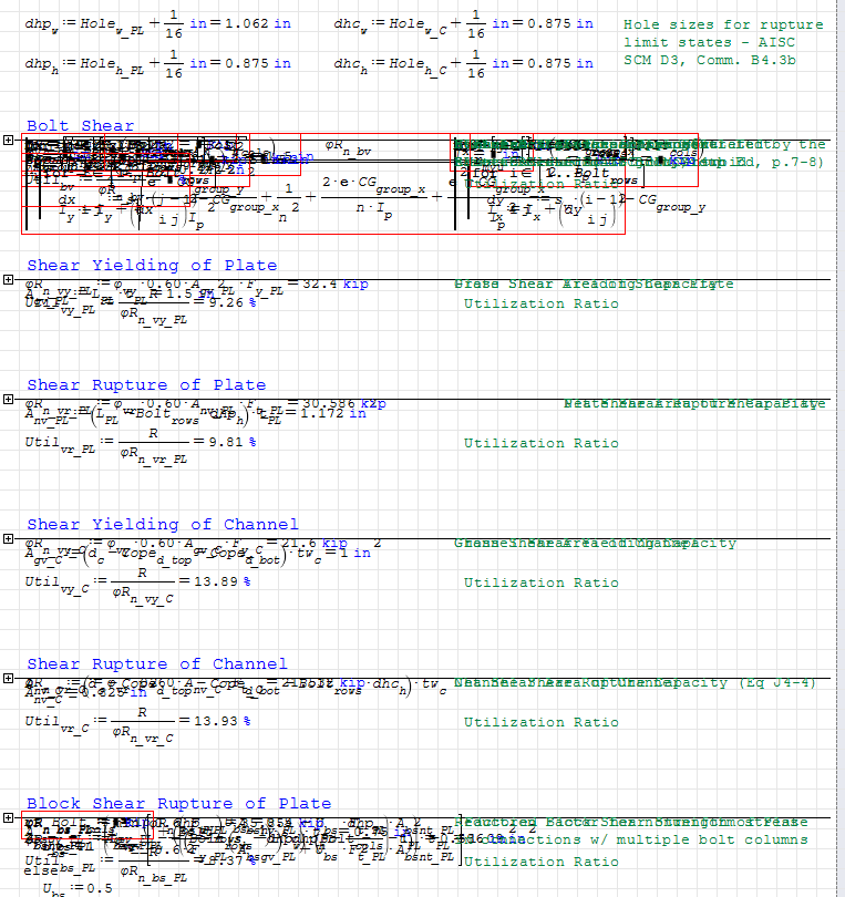

Area controls seem to have been adversely affected with this build. A worksheet I have where a lot of the calcs are hidden inside separate areas to allow for the option of a "summary" calc or a "detailed" calc opened up almost completely unreadable. It appears the contents of the collapsed areas are being displayed over the top of each other all in 1 line instead of being hidden inside the area. See the attached screenshot. Also experiencing some instability when trying to click on the area "+" signs to expand them. The areas don't expand, and instead completely disappeared once. Deleting one area at the end of the worksheet deleted all the calcs (4 pages with all areas collapsed, 10 or so pages fully expanded) except for the part that had been inside the first collapsed area on the first page.
Thanks,
Jason
Please could you send a file to me by e-mail to fix? I cannot reproduce this issue on any of my worksheets.

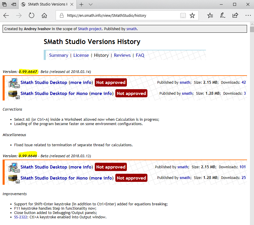

The following SMath Studio nightly builds are marked as NOT APPROVED and will not be suggested to download to anyone anymore: 0.99.6646, 0.99.6647!
