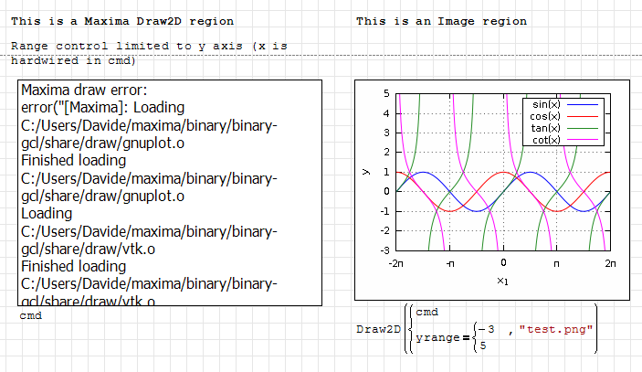

mhhhh.... Can see just error messages...
Martin Kraska 04.08.2014 10:21:00
#142 Опубликовано: 04.08.2014 09:51:39
This looks like you have tried the VTK interface in the same Maxima session (SMath instance). In order to revert to gnuplot interface for Draw you might restart Maxima using MaximaControl("restart" ) or open the update message in a virgin SMath instance.
I've simply opened you attachment (no further SMath instances running)
MaximaControl("restart") doesn't help
I attach the log.
Best regards,
Davide
I attach the log.
Testing was done using the portable distribution (Maxima 5.33.0), updated to the current SMath release candidate.
The log shows that you are using Maxima 5.31.1-1.
Update of the portable distribution is straightforward: Just take the SMath linux tarball and copy it's contents to the install dir of the portable distribution.
#146 Опубликовано: 04.08.2014 12:47:19
Ok, tried mixing the desktop SMath with Maxima 5.33 from your SMath package and it works (so the problem is just the Maxima version)

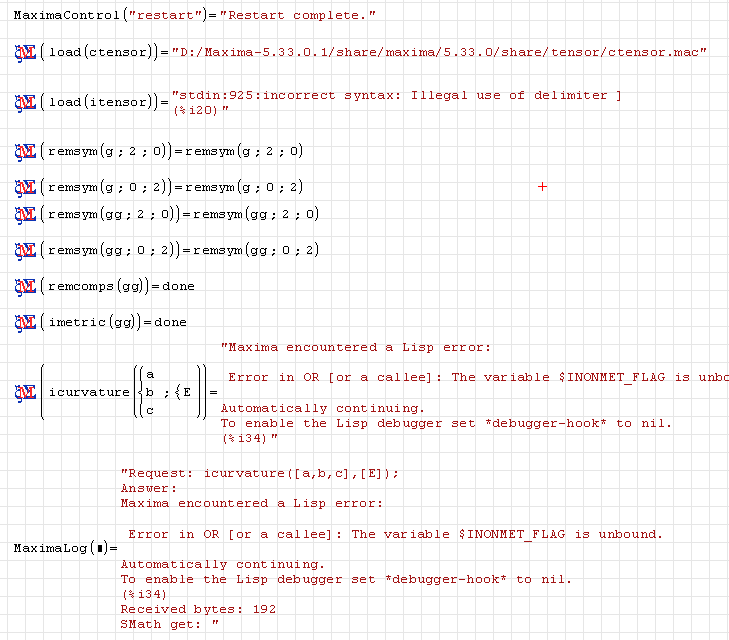

I am wondering if this maxima example could work on smath maxima ?
http://www.vttoth.com/CMS/projects/61-the-maxima-computer-algebra-system
#148 Опубликовано: 27.08.2014 14:23:59
I just gave it a try, see the result in the attachment. The packages seem to load despite the odd error message, probably due to a output parsing problem in the plugin.
The plugin, however, is not to blame for the failure of the icurvature command. It is correctly translated (had to use capital E in order to avoid translation into %e).
I used recent SMath studio and Maxima 5.33.0 as in the portable distribution.
If tensor stuff with co- and contravariant indices would work, one could think of providing a nice operator form via functions extensions. But it might be hard to tell these indices from ordinary matrix indices, subscipts or just exponents.

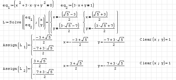

Hello, mkraska, got a question for you.
Does current implementation of maxima "Solve" function permit solving of system of equations (linear or non linear)?
If not, what command may I use?
Thank you!
#151 Опубликовано: 22.09.2014 15:09:02
Thank you!
Yes, this should normally work. There is an example in the Solve() handbook page, see [?]> Function index> S> Solve()

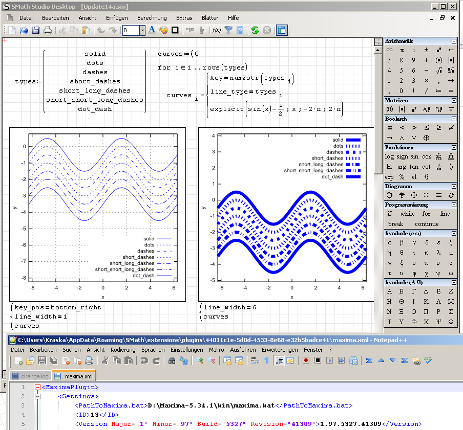

~\AppData\Roaming\SMath\extensions\plugins\44011c1e-5d0d-4533-8e68-e32b5badce41\maxima.xml
and changed it to:
C:\Program Files (x86)\Maxima-5.34.1\bin\maxima.bat

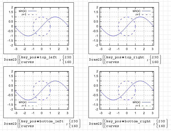

Based on the brand new windows installer for Maxima 5.34.1 the portable distribution has been updated. There are some new features in the draw package which can be used in SMath Studio:
- new option key_pos for placement of the legend
- support of more line styles for svg image format
