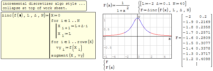

... super discretizer, algo style.
#12 已发布: 2021/1/19 21:08:42

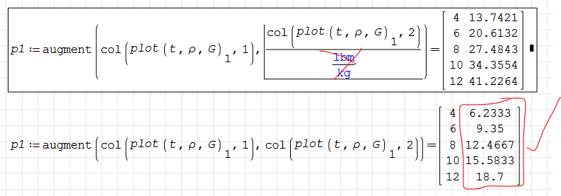

You need to delete the units in the your version as BER7 had accounted for it in the function ... I know you hate units. I need to digest your follwup posted sheet

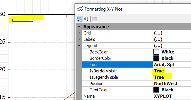

Really helpful. Is there a reason that a legend cannot be created on the plots (X-Y Plot) that are individual colors? I realize you used the built in graph and I updated my snippet sheet with the X-Y PlotCapture.PNG
NEVERMIND ... It'S under TRACES, not LEGEND

Thank you Jean,
X_Y plot does not recognize the multiple linterp, thus plots one trace only.
Alternately, you can add some sort of legend on the QuickPlot.

Thank you Jean and Ber7.
This has turned into a rabbit hole to document (notes) how to plot an equation with two range variables with a function. Is there a way to eliminate #X1 (t1 in this example)? In short, is there a function? or way to eliminate the units from #X (t in this example). Heat Capacity Function1.sm (20.42 KiB)已下载 1731 次。
Didn't work how I wanted, but similar to dividing vectorized (t/Unitof(t)).

... again, document empty "Incorrect Format"
Ber7 did the 2 var collection in nested vector form,
my last version is table style, much more convivial as I'm used to do.
Units are just a pen in the ass[hole].
A good way is to work units-less, then append silent units.

Thank you guys. I should have just deleted the question when I figured out the legend issue in lieu of answering myself. As mentioned above, it was under TRACES, not LEGEND, in the X-Y Plot

This is my current hang up with the units
