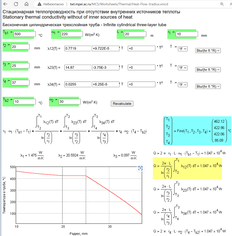

I would like to to sole the linear equations
F1=F2=f3=F4 with 4 unknowns T1, T2, T3 and T4
I can do it in Mathcad (given-find). but cannot in SMath ;-(
Help me please!
See please the Mathcad Calculation Server
http://twt.mpei.ac.ru/MCS/Worksheets/Thermal/Heat-Flow-3radius.xmcd
my SMath try in attach and
Lambda3.sm (434.36 KiB)已下载 1620 次。
the picture

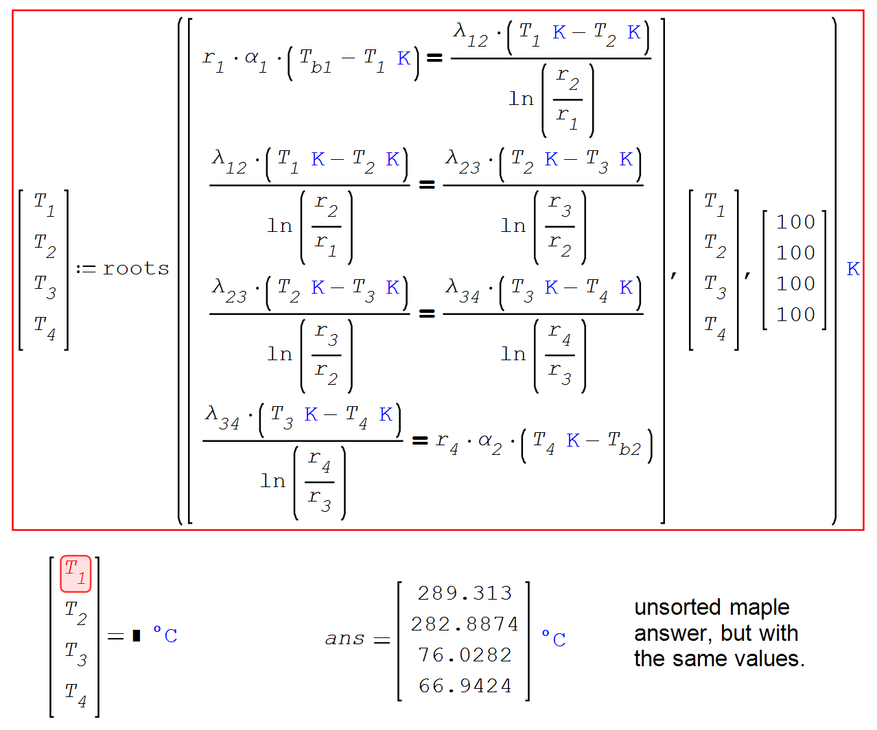

Hi. Here two options for solve the system.
Lambda3.sm (452.05 KiB)已下载 1625 次。

I see Alvaro has beaten me to it, but here's my approach anyway.
Lambda3b.sm (470.18 KiB)已下载 1675 次。
