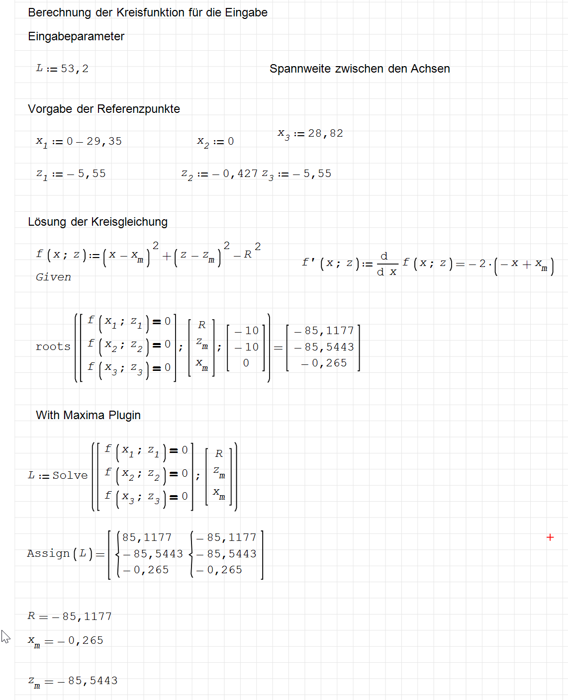

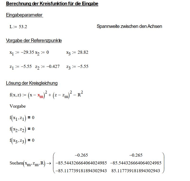

Im trying convert this mathcad solver to smath but it doesnt work.
Radius_318a.sm (9.34 KiB) downloaded 1017 time(s).

It is a non-linear system. With the internal "Roots" solver it is appropriate to use initial values ​​sufficiently close to the result.
You can use some of the smath plugins that are more robust. For example, with "Solve" of the "Maxima plugin you get the result.
Show Spoiler
Radius_318a_ser.sm (337.14 KiB) downloaded 1092 time(s).

With an addition to sergio's solution;
You can use vectors while solving.
#4 Posted: 2022/1/21 20:59:15
597 likes in 1,377 posts.
Solution with another solver.
al_nleqsolve.sm (6.99 KiB) downloaded 984 time(s).
