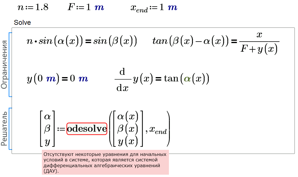

How can we use here a Mathcad-block?
Lens-Mathcad-Block.sm (43.8 KiB) downloaded 1486 time(s).
See too
https://en.smath.com/forum/yaf_postst25212_Lens.aspx
#2 Posted: 2024/12/1 18:08:12
1,544 likes in 1,859 posts.
Here the function rkfixed() can't process the incoming expressions correctly. The block has nothing to do with it, it does not perform detailed analysis of expressions.
This is a bug in the function. The function has not been tested for this case. I can't see what's wrong here right now.

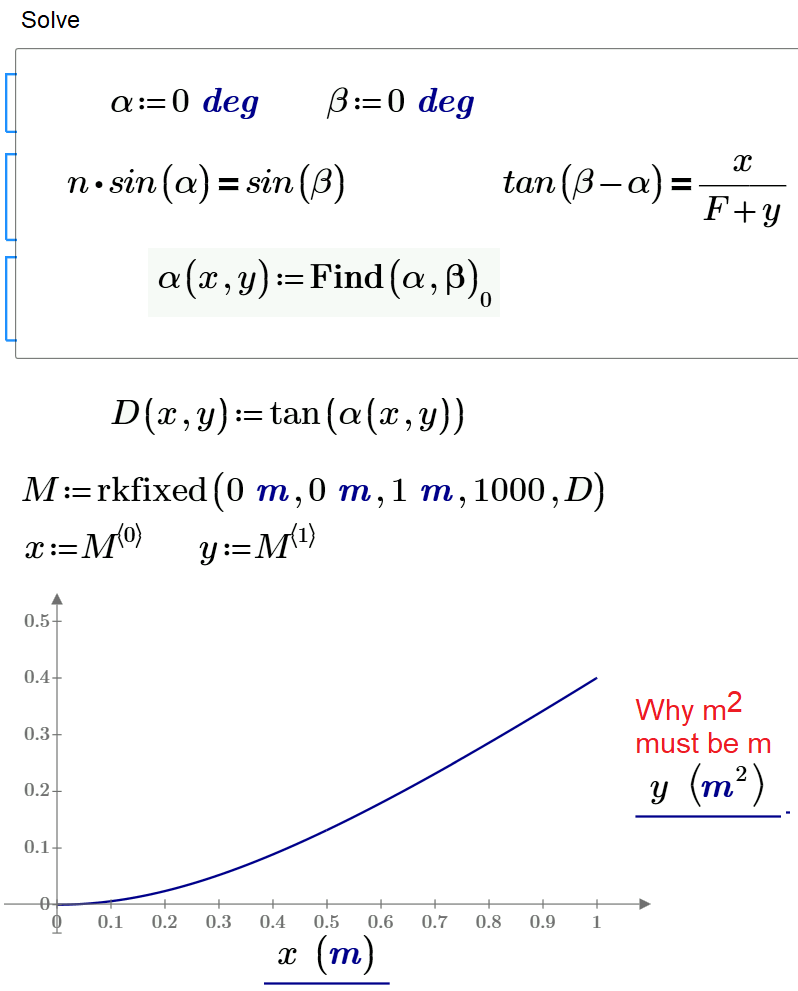

This is not a solution of the rkfixed problem, just a little playing around with X-Y plot.
Here, an option of setting the aspect ratio of the axes to 1 would be good.

I am wondering if there is such a kind of Mathcad Prime odesolve for solving differential equations numerically also for SMath Studio somehow?
#6 Posted: 2024/12/8 01:21:21
Valery Ochkov
Valery Ochkov
66 likes in 682 posts.
Not yet, but will be soon!
Question - why is the answer meters squared, and not just meters?
What's wrong with the existing solvers?
#8 Posted: 2024/12/8 03:54:39
Cornel
Cornel
2 likes in 78 posts.
Because odesolve in Mathcad Prime:
1. Do not require to rewrite the differential equation of a higher order into a system of first order odes
2. Determines whether a system is stiff or nonstiff and then is using accordingly the stiff numerical differential eq solver or nonstiff numerical differential eq solver
3. Can solve numerically a system of differential equations (whatever it's a system of first order differential eq or a system of higher order differential eq)
What are these existing numerical solvers of differential eq in SMath? What are the posibilities of SMath to solve numerically differential equations? Exist at least one solver that mimic the Mathcad Prime odesolve (i.e. the 3 points above menționed)?

Hi Cornel. For points 1 and 3, SMath can do what Mathcad can, and just a little more. Please, check the first post in this plugin. Can mathcad solve this odes?
RKA.sm (308.62 KiB) downloaded 1817 time(s).
RKA.pdf (931.16 KiB) downloaded 1277 time(s).
About point 2, one would have to review the documentation for the following plugins to see if they are capable, and to what extent, of doing what you are asking, and choose it for the solver in the SMath's solver block.

Hi. dsol can solve it with this setup:
RKA-Lens.sm (179.91 KiB) downloaded 1446 time(s).
I also use the Martin's setup for the plot.

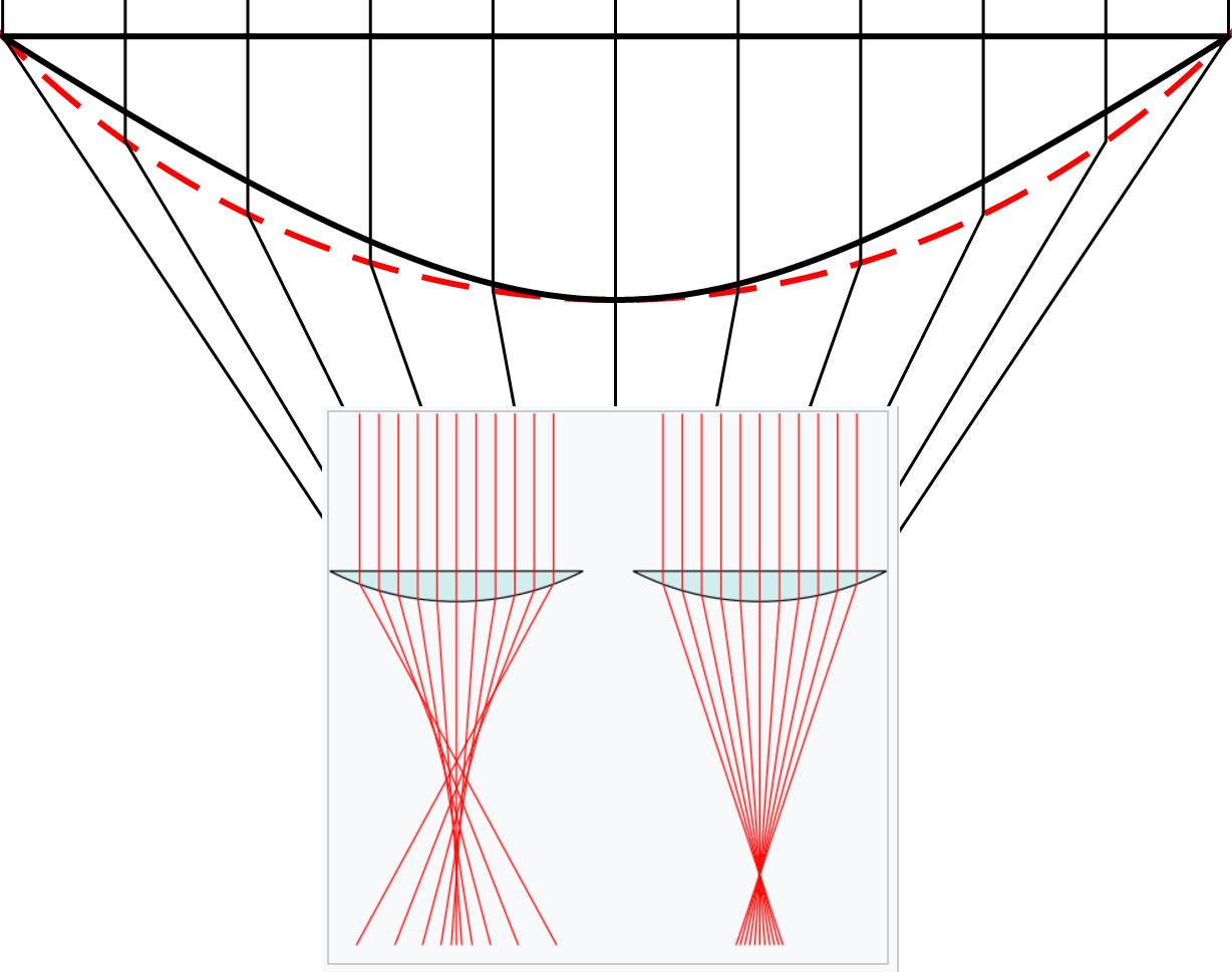

How to create this picture
https://en.wikipedia.org/wiki/Spherical_aberration

Hi Valery. This is a way.
spherical aberration.sm (15.88 KiB) downloaded 1440 time(s).

The last step
#14 Posted: 2024/12/10 21:21:41
1,106 likes in 1,784 posts.
Hi. The screen. I also simplify a little the calculations.
spherical aberration.sm (26.41 KiB) downloaded 1546 time(s).

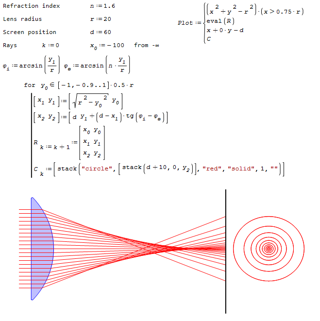

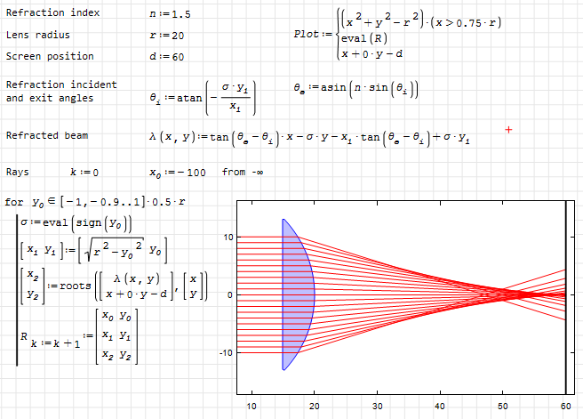

Root-free version of the spherical lens
spherical aberration_Kr.sm (12.37 KiB) downloaded 1381 time(s).
Alvaro 2024/12/11 06:18:00
Oscar Campo 2024/12/12 18:29:00, Alvaro 2024/12/13 07:27:00
