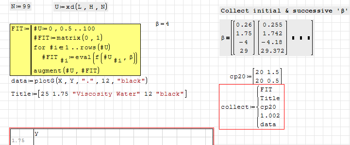

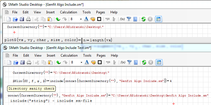

Using Jean's files in the same directory, I updated to Mike's sheet and compared it to UNI's pdf ... I still have an error in the re-definition of BETA. Using latest SMath and plugins.
This is on my work computer ... not the one at home.
BTW, I tried with both files on my desktop and in the "C" drive.

Not that BETA ... the one to the right of "FIT" per my screenshot. Everything up to that point matches UNI's PDF. I've tried moving the "BETA" down. I think that is why I have red boxes below.

βNlin() redefined (βNlin() := include() = 4).

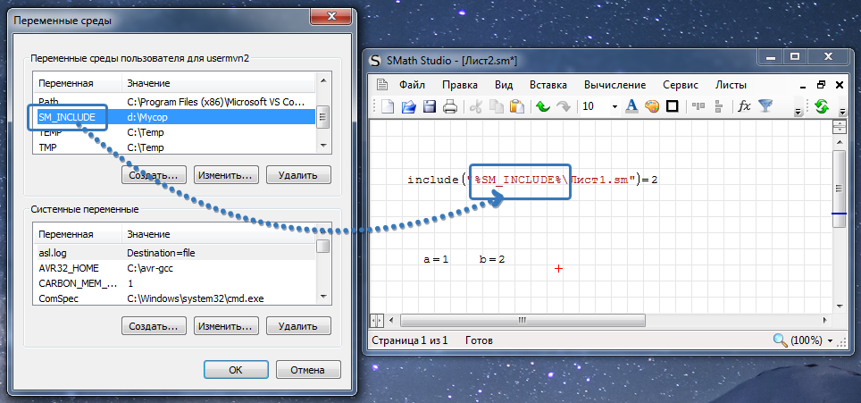

Access to Windows Enviroment Variables would be really nice:
include("%SM_INCLUDE%\fn.sm"=10
Do you think it's possible?
Thank you
#106 已发布: 2017/7/26 02:31:54
1,558个赞,共1,868个帖子。
Yes, it is possible. Will be in new release.

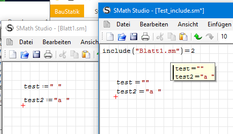

found a little bug in include():
Strings containing only one space " " are imported as an empty string.
#113 已发布: 2019/2/22 08:40:39
1,558个赞,共1,868个帖子。
Updated. Try now.

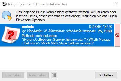

What a quick answer!
I forgot to mention, that I use the latest stable 0.99.6884.
As the plugin is not offered through the plugins dialog, I downloaded the latest file directly and replaced the current one.
But that doesn't work:

The plugin was compiled for a more recent SMath Studio, that's why you can't get it through the extensions manager and why you get the error message (in short the library rely on a different interface than the one available in your version, they can't talk each other)

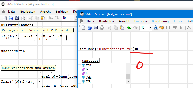

I have a more comprehensive sheet, which I include:
now (0.99.6988 with updated include extension) the result of include is shown as usual (98 elements), but they are not accessible:
At first start a few equations were present, but finally I can't get it to work.
I can't even say, if the beta Smath app or if the extension is making troubles.
Show me .log file from the plugin directory.
Hi. Related, but in SMath:
