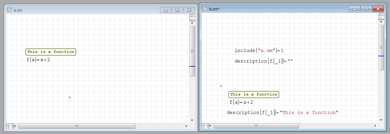

#92 已发布: 2016/4/14 14:32:29
Arie
Arie
94个赞,共285个帖子。
Is it possible for descriptions to be passed with include()?
See example
Mike Kaganski 2016/4/14 23:47:00
#93 已发布: 2016/4/15 02:07:43
1,558个赞,共1,868个帖子。
No, now this is impossible. Function (AddDefinition() from SMath core lib ) which does the main job dosn't know about the description field for the definition. So I can't add this data.
