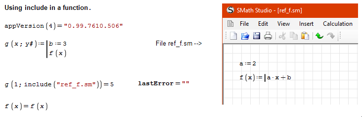

Hi. First, thanks for your work. I think that include it's one of most important tools in SMath for write advanced functions, like ode solvers, in native SMath code, instead of use C# plugins.
It's possible using include in a function body? Please, see the attached. In case that it could be, can also be values in include only local for the caller function, and not to the entire worksheet?

using "include" as a function parameter can work around the problem!?
Alvaro 2020/11/18 13:36:00
#129 已发布: 2020/11/18 13:35:22
1,139个赞,共1,805个帖子。
Hi Pompelmo. Absolutely. That' exact what I want. Thanks very much.

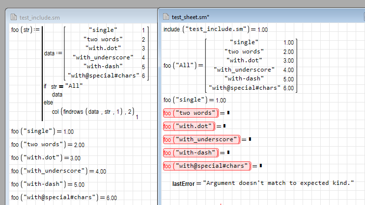

Hi. Thanks for this plugin. I found it very useful in creating a single custom functions file for my team.
I'm encountering errors when I have strings with spaces or any other special characters as arguments. If I call the function within the included file there's no error. Does anyone have an idea on what's causing this?
Thanks.

#138 已发布: 2021/12/10 06:22:01
1,558个赞,共1,868个帖子。
SMath Studio compatibility
Plugin updated. Please try.
Changes:
- added encoding of special characters in the text.
sergio 2021/12/10 08:53:00
The update solves the problem. Thank you very much uni.
