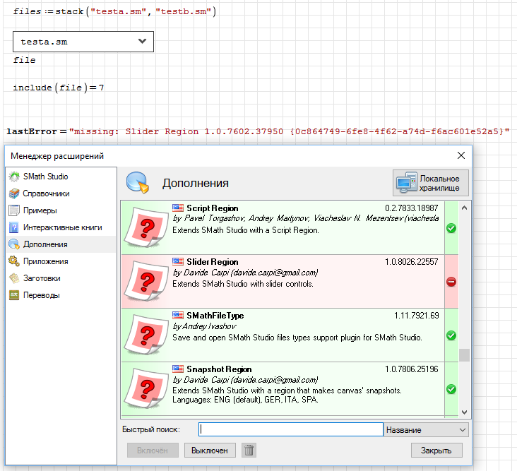

Plugin updated.
Changes:
- added support for: numericupdown, pathpicker, mathcad block, script;
- lastError shows missing plugins for the last included file (function compares the dependencies of the include file with the current set of enabled plugins).

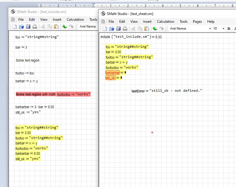

Hi uni,
Thanks for the new updates. I found a bug. If I have a text region that has a formula, formulas after it will not be included.
test_sheet.sm (4.39 KiB)已下载 1656 次。
test_include.sm (6.79 KiB)已下载 1714 次。
This was the last version where I knew that it worked:
SMath Studio compatibility
Plugin updated. Please try.
Changes:
- added encoding of special characters in the text.
#144 已发布: 2022/2/19 15:02:12
1,558个赞,共1,868个帖子。
Plugin updated. For now I don't know how to parse math equations inside text region correctly.
Changes:
- text region partially supported.
Chito 2022/2/19 19:31:00
