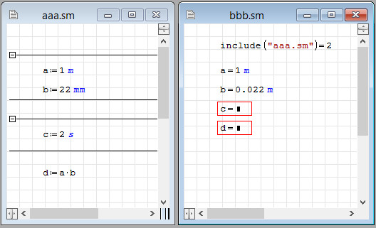

It looks like there is a bug if you include Areas in the source file.
If your data is included in more than 2 Areas, the plugin will send only the content of the first one.
#58 已发布: 2014/12/1 13:26:53
1,558个赞,共1,868个帖子。
I think this is not only my bug. I ask Andrey about it.
#59 已发布: 2014/12/7 14:15:07
1,558个赞,共1,868个帖子。
We found the problem. This issue is related to saving the file. Andrey will make the correction in the next build.
