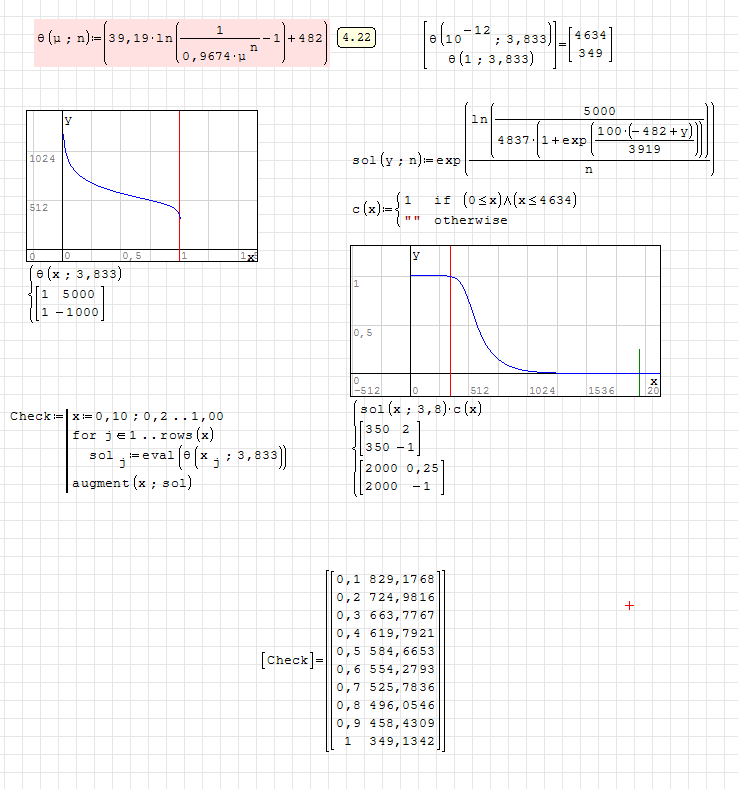

I'm sorry, but I really don't understand your approach to solving the equation 4.22 for my.0. But the results in the Check-matrix are indeed correct. Can you please explain what you did there?
Thanks
By inspection, if μ is < 1, we know in advance the result will be complex.
The "check" was to confirm this assumption. When you say solve for μ,
you are correct in your own words. In fact the matter is to inverse the roles.
From the explicit f(x):= ... where 'x' is given on range, now you want the
inverse of the procedure, i.e: given f(x) solve for 'x'. The procedure is
called "inversing". The Maple solution is the InverseFunction.
On that, Smath/Maple companions are far superior to Mathcad 11/Maple.
Please, read more on the revisited work sheet.
I will look at Radovan.
Cheers, Jean
4.2.5 Steel temperature development.sm (38.13 KiB)已下载 1087 次。

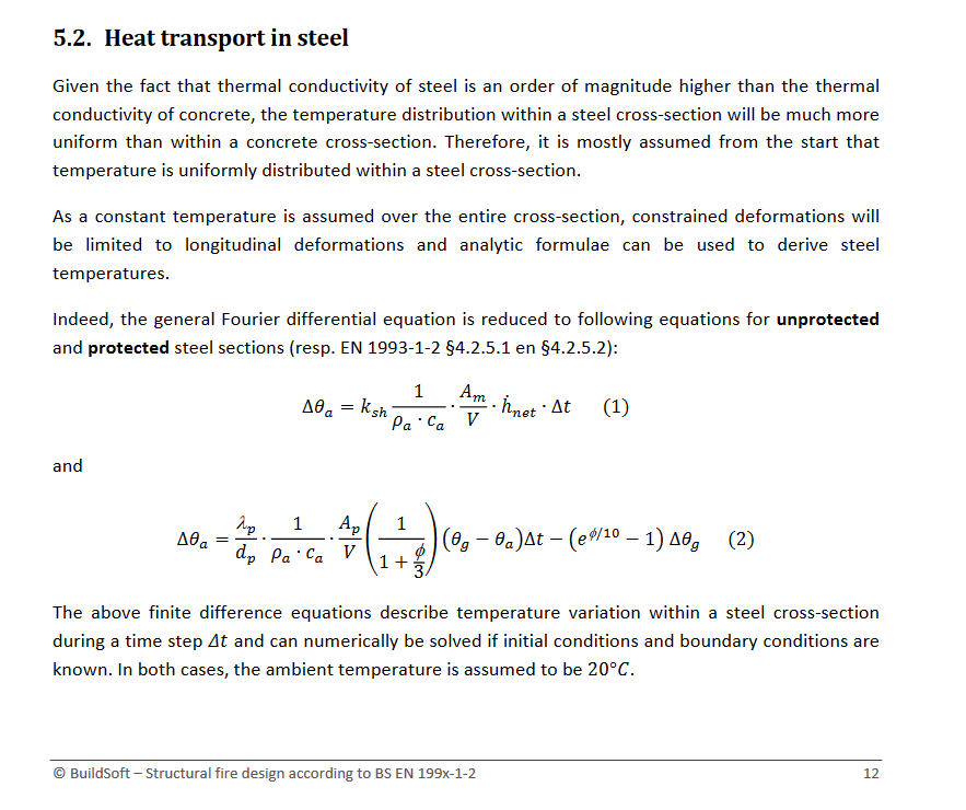

I am sure this is a rather common problem in the world of chemistry and chemical engineering?
Best regards,
Edit: found a pdf which have tabulated θ.a(t) for different values of k.sh*A.m/V (=0.9V/A.m,b)
Page 7-10
tables for theta.a
Edit2: found another pdf which discusses the differential equation. It is apparently a Fourier equation, if that helps matters any.
Page 12-16
Fourier equation

Do you think I am onto something here?
Well done ! just add some of the EuroCode equations number ...
Cheers, Jean
testing 4 ode [Gorgeous].sm (24.18 KiB)已下载 940 次。
Thank you for your compliment!
This would not have been possible without the help from you and Radovan!
BTW, I think I uploaded a later version than the one you editen. My latest version is v3, which includes two expressions that returns temperature and time for any given point, across the 4 ODE's.
