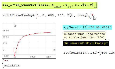

#73 已发布: 2018/5/8 00:47:40
983个赞,共6,866个帖子。
Jean,
I can not get it to work in my current version of Smath.
Is it possible another solver has to be used? One of the Runge-Kutta versions maybe?
You are quite right though, the fact that the first of the four equations work on your sheet suggests that it should work. However, that values in the solution you posted is quite wrong... Not quite sure why that is though, has to be something with the input.
I'm quite curious as to what the workaround/solution to this project will be. Looking forward to seeing what you will come up with
Hanski,
A bit of headache
Those solver may fails ... guess the cause "Division by zero".
You should have the first segment running as the picture.
Just to show how difficult it could be, read the ODE Yuk.
Temperaturforlop Compactum.sm (60.13 KiB)已下载 1119 次。
#74 已发布: 2018/5/8 00:52:39
983个赞,共6,866个帖子。
A bit of headache
Forgot to add: possibly a piece wise Finite Differences
will do. Just a matter of setting it correctly. That will
not "divide by zero " !

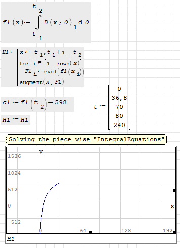

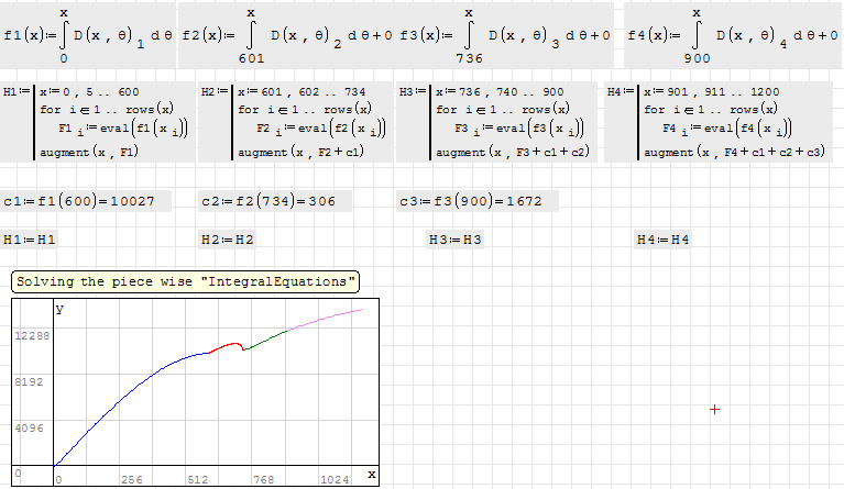

#77 已发布: 2018/5/8 22:44:00
983个赞,共6,866个帖子。
Is Mathcad able to handle this DE? Can anyone try to solve it there?
I doubt because rkfixed, Rkadapt are same.
The first segment maybe ? from the "Stiff option"
Good news is that the project has an elegant solution.
It consists in solving the Integral Equation
Will post it before bed time ...
#78 已发布: 2018/5/9 00:03:51
983个赞,共6,866个帖子。
... maybe there is some applicable scaling factor ? ?
Temperaturforlop Compactum Copy.sm (48.23 KiB)已下载 1178 次。
#79 已发布: 2018/5/9 04:31:13
hanskl
hanskl
7个赞,共158个帖子。
Interesting! I will look into this later this evening!
But from the top of my head - the X-axis should represent time in minutes, not temperature.
Also, it took quite some time for the sheet to finish calculating.
Best regards,
Hans Kristian
#80 已发布: 2018/5/9 10:55:01
983个赞,共6,866个帖子。
Best regards,
Hans Kristian
1. You can leave it in native 't'
2. the default Integration accuracy is 100, set it 50
it will have no influence in this application but much faster.
1.7 min in my 1.66 GHz laptop runs 225 greedy maths.
3. Does your version bracket t:=[0,5..600] ?
rather than Smath 6179 t:=0,5..600
Temperaturforlop Compactum Copy.sm (53.22 KiB)已下载 1159 次。
