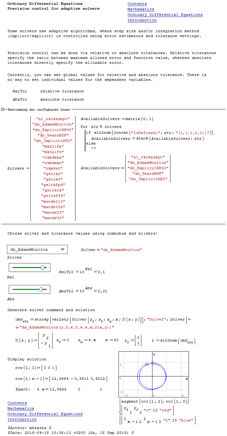

After recently learing how to write for loops, this forgotten project popped back up in my mind again..
My newfound knowledge got me quite a bit further, to the point where i think this project is complete as well.
Just one question - is it possible to define a function quickswitchODEsolver(a,b,c,d,e)=ODEsolver(a,b,c,d,e) <-- This could be Rkadapt() for example, or maybe another solver.
Can the 8 different resolutions then be solved by quickswitchODEsolver()?
The goal is to have to change the solver function only one place rathere than 8, if I want to switch.
Cheers.
Temperaturforlop.sm (119.63 KiB)已下载 1139 次。
There might be smoother ways but this works. Note that I had to replace the sliders because the old regions don't seem to work any more with new SMath versions.
Section Math ODE precision.sm (23.08 KiB)已下载 1097 次。
