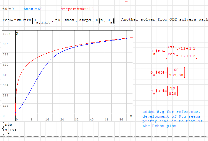

4.2.5Steeltemperaturedevelopment-reply-3.sm (80.73 KiB)已下载 1177 次。
The plots are finally starting to resemble that of Robot!
I have made pointed out the one variable I am uncertain of in the bottom of this file.
It seems the time is still in minutes, but is the temperature in Celsius?
Is there a way to return the temperature after t minutes? In the snapshot from Robot you can see Oa,max=940,96°C after treg=60,00min.
Ultimately, the goal is to have the equation return the temperature after a given time θ.a(t).

I think I found a solution to return the temperature after a given time.
There might be better solutions for this though?
#11 已发布: 2017/10/26 05:14:39
325个赞和1个踩,共2,052个帖子。
As you have points from the solution you could make a function from them by spline interpolation (for example).
See the attached file. By the way, you do not need to many steps for these ode solvers.
4.2.5Steeltemperaturedevelopment-reply-3-corr.sm (89.88 KiB)已下载 1158 次。
