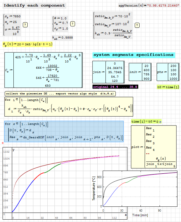

WroteDo you mean something like "Steelfire" done/augmented a while ago ?
Like this..

Steel_temperature_complete.sm (90.65 KiB) downloaded 930 time(s).
WroteI guess I've spent too much time on SMath.

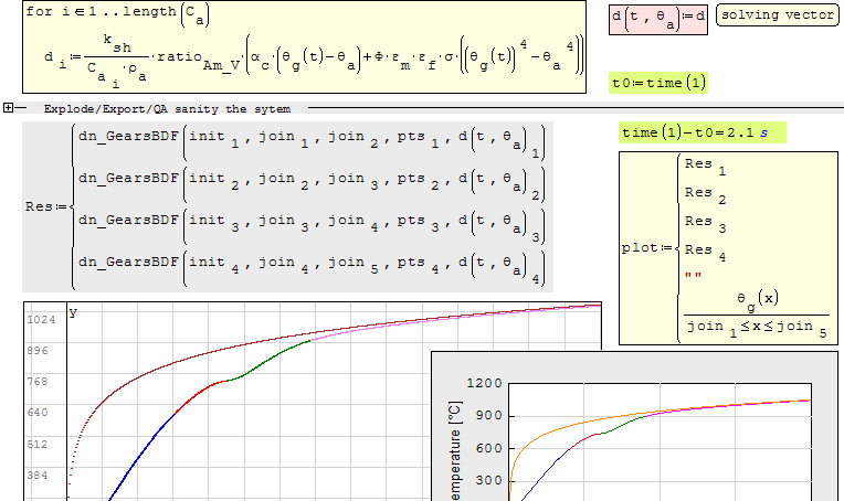

Spare time to adapt your project around the more advanced ODE multi-condition.
Be careful about Bolean, sometimes tolerant but generally must be specified completely.
Mathcad was more tolerant Bolean, however had to be doctored many times in Collaboratory.
Naturally, your document is red top to bottom SS 6179.
It is so much over killed of useless, it should pass QA piecewise.
If you join visibly, no need for the TOL.
In short wrt your SS version, you must arrive at the exportable pieces.
Each piece for QA sanity check [Matlab, Mathcad ...]
ODE Multiconditional [Carlos Compactum] Copy.sm (80.79 KiB) downloaded 804 time(s).

The document is indeed red top to bottom.

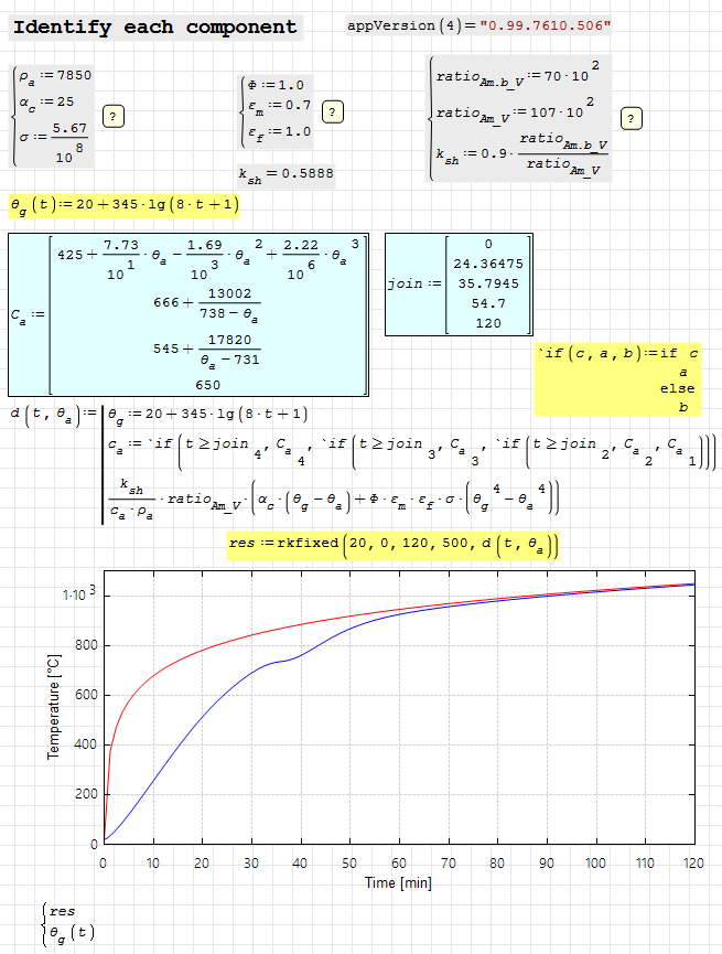

Anyway, although the document became less "techincal" after uniting all pieces in one single ODE using cases(), the project is now complete after some testing against a Excel spreadsheet I found online.

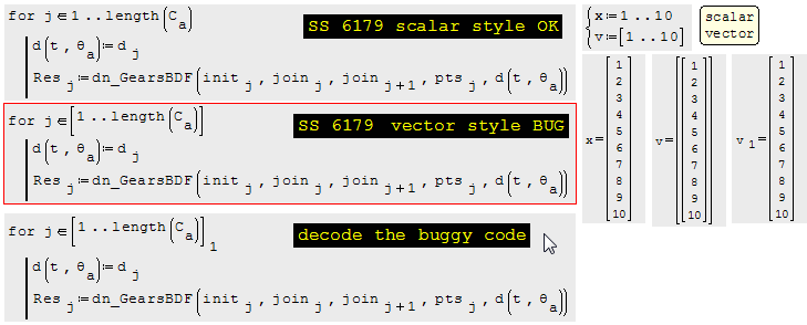

WroteJean, I just printed this PDF.
Thanks Hanski, that identifies the Smath bug.
Since which SS version, that bug exists ... ?
If you can't doctor as given, end of most Smath.

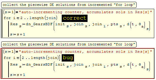

Of so many utilities that make Smath productive, the auto-increment for loop
is by large the most used and necessary. If I would update my 6179,
a great percentage of my 2500 documents would turn red hot.
Hope designers read this. If not acknowledged, will report in "Bugs"
Was that bug introduced at time indexing the LHS definition 'data[i:= ...'
At work Doctors
This document simulates the bug of your SS version,
it decodes the bug. So, the TEST version and the all original
should work top to bottom. If not => desperate case, recycle.
JeanDoctored version.sm (31.28 KiB) downloaded 955 time(s).

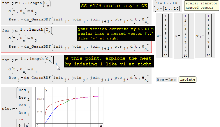

1. That piece that turned red in your *.PDF, try to code as per Uni snippet.
2. Otherwise, try to doctor the damaged SS 6179 as demonstrated.
There is no justification for your SS version to convert SS 6179 scalar into nested vector.
That to me is a bug that may render zillions documents red from the Samples Repository.
Please report where you stand-in [blue sky, red document, OK].
Cheers ... Jean.
ODE Multiconditional [Carlos Compactum] Copy.sm (82.73 KiB) downloaded 752 time(s).

Yes, not happy latest SS converts SS 6179 scalar into vector.
