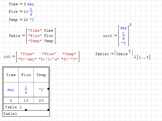

Will it be possible?
Units_Table.sm (7.85 KiB) downloaded 1058 time(s).

sets the header and units matrices
Davide Carpi 2018/3/22 08:17:00

Thanks Sergio:
You made me remember the solution that Martin Kraska gave me, but I can not put a header on it.
Do you have any suggestion?
Units_Table_r2.sm (15.19 KiB) downloaded 1109 time(s).

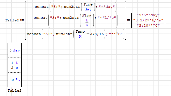

I thought about this (string manipulation)
but num2strtransforms into fractions
Use var2str() from CustomFunctions instead
sergio 2018/3/22 14:07:00, frapuano 2018/3/22 17:29:00

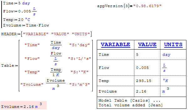

Using the unit summary to convert units back to original units doesn't work for temperature conversions. What you are doing with the units summary assumes the conversion is a factored multiplier. It works great for everything except temperature (or any other unit doesn't scale by a factored multiplier).

Maybe try something other than 20 deg?...
Version: 0.99(build: 6671)

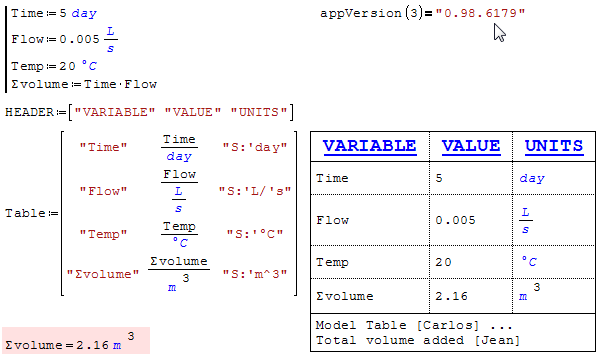

You are quite right and there are two things here
1. As it looks, the °C can't be made user.
The unit system is grounded on 'K', bloody pest to me.
2. The other thing is the Shadow in context, a real bug.
It worked fine from Carlos original [by what coincidence ?]
Not changing the context, context reproduces. Changing context
and the all thing °C gets freaked. I observed that many times
in Smath. In fact, very problematic.
Thanks for this wise observation.
Table Region Carlos.sm (10.6 KiB) downloaded 1073 time(s).
