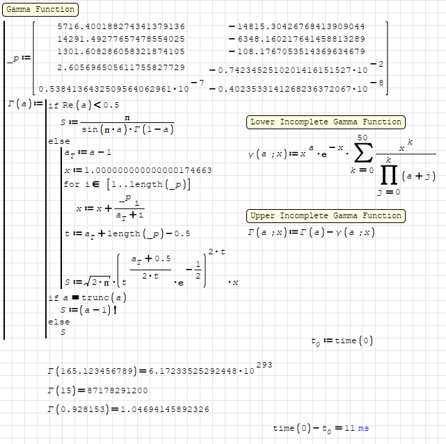

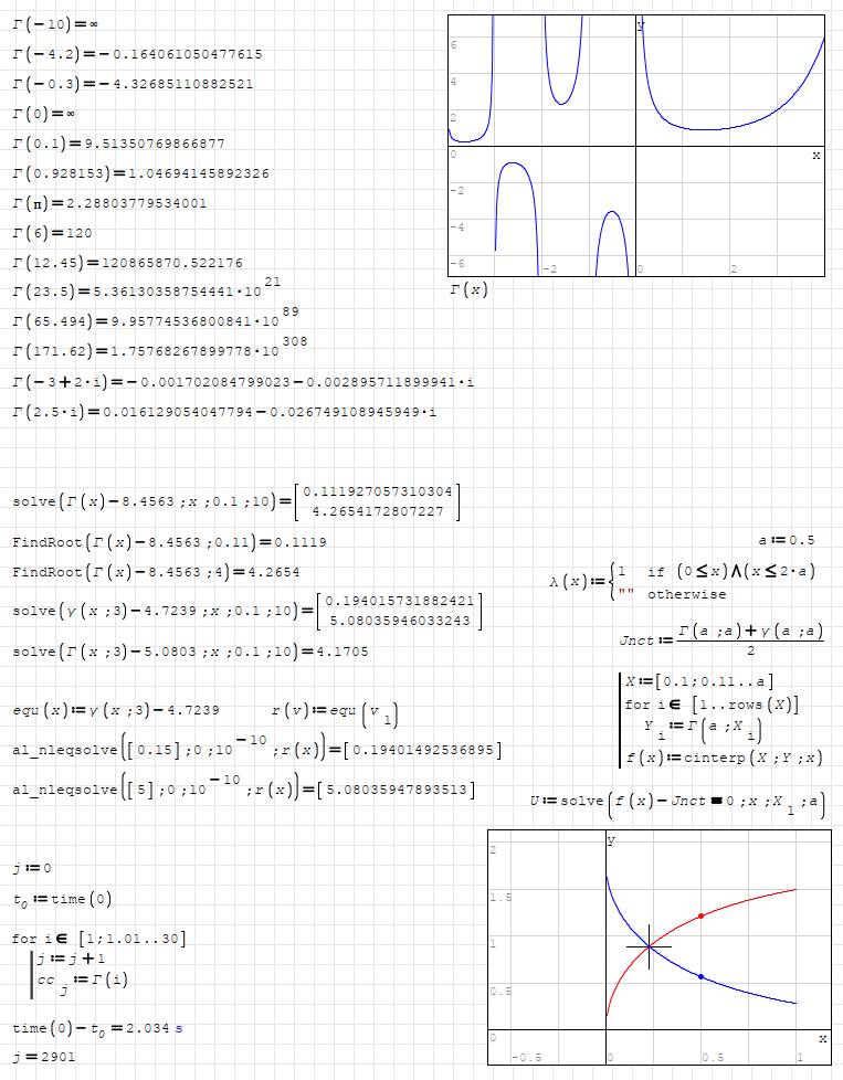

Gamma function,
Lower Incomplete Gamma function,
Upper Incomplete Gamma function,
with almost instant speed and high precision.
gamma.sm (34.69 KiB)已下载 1447 次。 <---- least accurate
gamma_r2.sm (11.52 KiB)已下载 1436 次。
gamma_r3.sm (11.8 KiB)已下载 1434 次。
gamma_r4.sm (13.82 KiB)已下载 1435 次。
gamma_r5.sm (11.38 KiB)已下载 1479 次。
gamma_r6.sm (17.75 KiB)已下载 1401 次。
gamma_r7.sm (28.8 KiB)已下载 1520 次。
gamma_r8.sm (31.51 KiB)已下载 1543 次。
gamma_r9.sm (36.93 KiB)已下载 1940 次。 <----imaginary numbers added
#2 已发布: 2021/6/8 14:57:24
600个赞,共1,381个帖子。

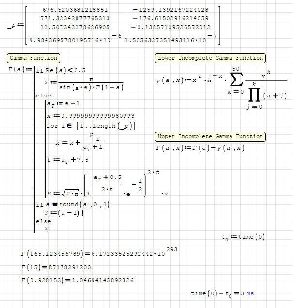

Thanks, will explore.
Main limitation is smath floating points.
Python gives much more accurate results with same algorithms.
Try the other one for gamma calculation.

round(■ ,■ ,■ ) ... undefined
H.T.Davis [Abramowitz & Stegun] -> very objective.
In the mean time I'm finishing two superb applications examples
... examples based on your first Gamma(a,x) version,
Thanks for that one, gorgeous ... Jean.
gamma_r2 [H.T.Davis].sm (57.43 KiB)已下载 1238 次。

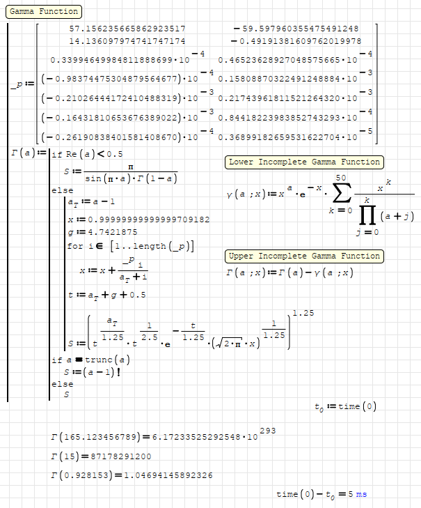

600个赞,共1,381个帖子。
Undefined because you have an old version of smath.
Round(#,#,#) is not parsed through your program.
Use trunc() instead. And with more constants.

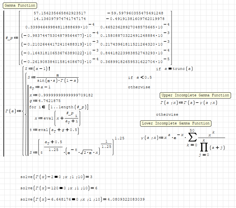

600个赞,共1,381个帖子。

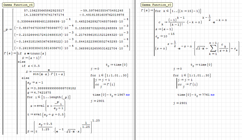

Technically this should be the most accurate one.

I suggest you to change gamma function with gamma_r4.
It is 3 times faster and much more precise.

Speed may differ between linux and windows.
gamma_r4 is faster 3 times in linux.
What do you mean by 'does not solve'?

1. NO gain timing both applications
Latest version is faster about 4 times.

#16 已发布: 2021/6/9 22:22:56
600个赞,共1,381个帖子。
It seems solve(), roots(), FindRoot() doesn't like if statements.
I have updated the bugreport in Bugs and Problems > solve() bug.
Using cases() seems to solve the issue. Check the sample below.
#17 已发布: 2021/6/10 11:16:16
983个赞,共6,866个帖子。
Doctored version confirmed.
#18 已发布: 2021/6/10 22:56:05

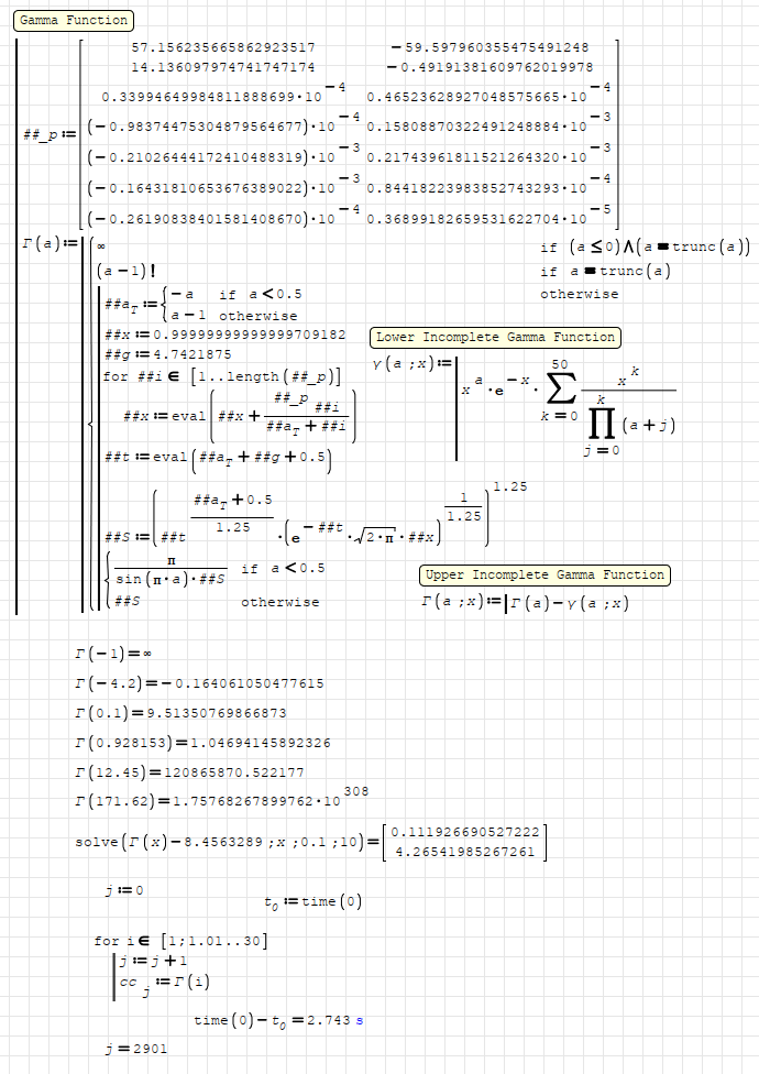

600个赞,共1,381个帖子。
gamma_r5 has a serious flaw. It can't calculate a<0.5.
My bad, should check it carefully. Corrected page is below.
Refactored so it is faster, also get rid of recursive call.
I had to get around some smath bugs with line, if/cases, recursive.
Correlation of them gives weird errors.
Hope this version solves all issues and be the last one.
I know I have flooded this topic too much, sorry for inconvenience.

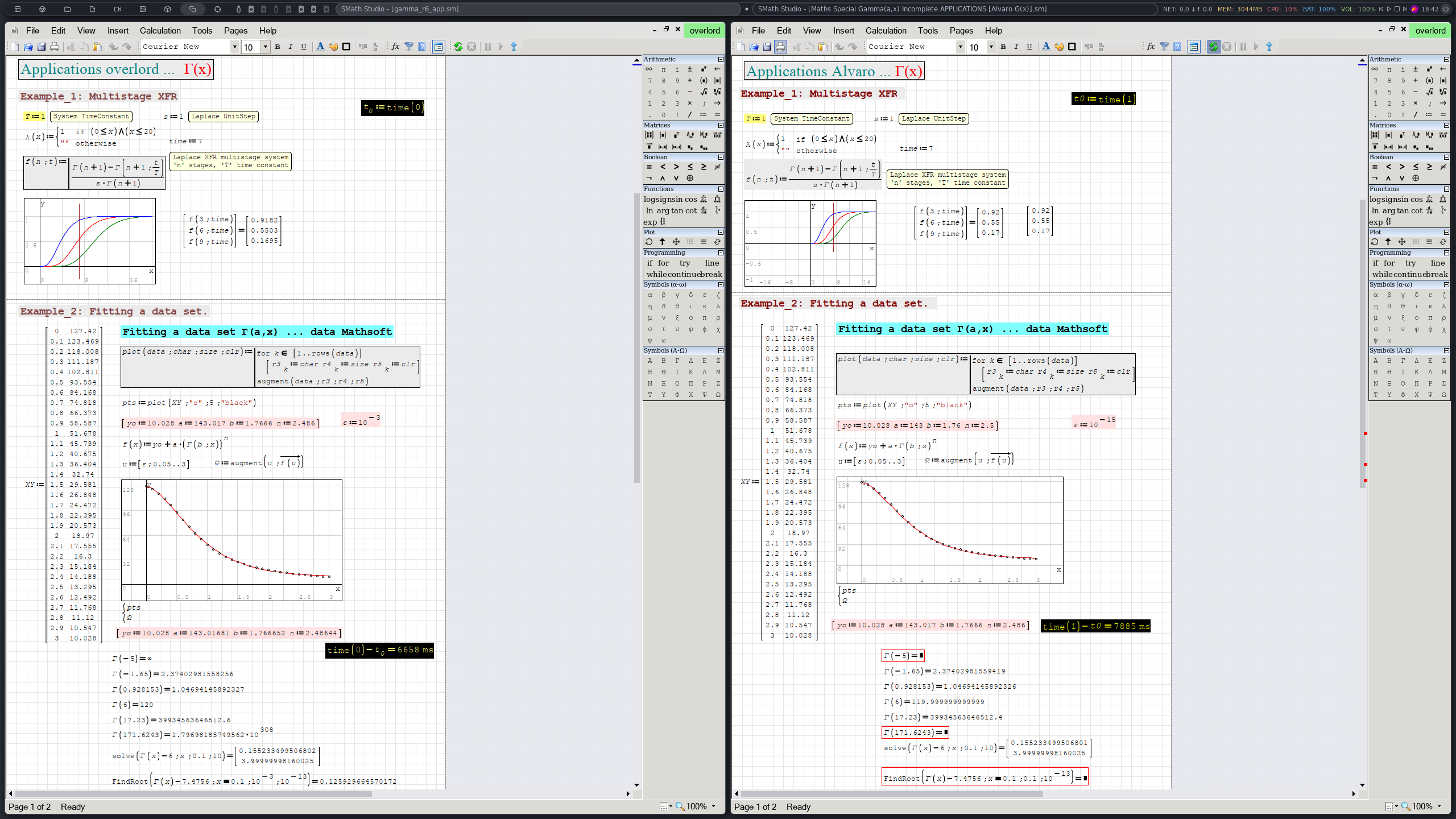

You may not like my verdicts:
1. on-line faster has no or little interest, neither up ^307.
2. Your first version runs fine the two applications.
3. The champion is the long time ago published Alvaro Γ(x)
4. for these two applications [2] & [3] are same
but => [3] drops timing [2] from 24 s down 18 s
The drop in timing results from Alvaro Γ(x)
running at the kernel scalar level.
BTW, my original H.T. Davis sanity Mathcad & Alvaro Γ(x)
By same token, thanks Alvaro for your Γ(x).
Maths Special Gamma(a,x) Incomplete APPLICATIONS [Alvaro G(x)].sm (26.94 KiB)已下载 1243 次。
#20 已发布: 2021/6/11 12:45:20
600个赞,共1,381个帖子。
1. 10^308 feature added for fully use IEEE capability.
2. gamma_r6 runs every possible applications.
3. don't want to disrespect, Alvaro's is a single line awesome code.
4. mine has same algorithm with more features, with faster calculation.
4. gamma_r6 is faster from gamma_r2 and gamma_r3 while trying to have all feature.
gamma_r6_app.sm (33.87 KiB)已下载 1433 次。
Here is a side by side comparison with Alvaro's algorithm with mine.
On linux, gamma_r6 is faster about 20 percent.
