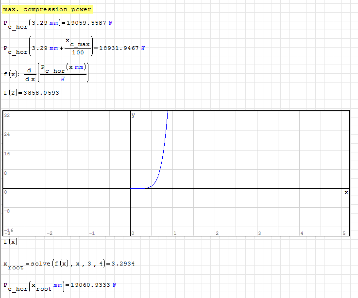

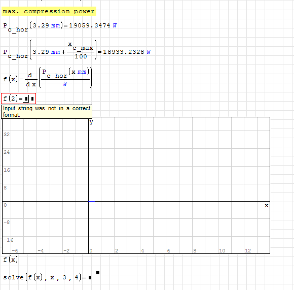

In the first screenshot, the function derivative definition results in a warning message: "input string was not in a correct format"
In the last screenshot, I removed all parameters values that aren't related to the given formulas (not visible in the screenshot), and I get the right solution?! However, I don't see the root visually in the accompanying graph?

What I meant was that the derivative graph doesn't cross the X-axis at x=3.29, this is where the original function P_c_hor(x) reaches it's maximum.
This is odd, since the root function indicates correctly a root at x=3.29 in the file NOK.sm (I switched the names the smath files, my mistake... ).
So my question remains: why does the solve function doesn't work in both attached files?

I run the latest beta (build 6437), and f(2) on the last page of "ok.sm" doesn't result in an answer (the standard smath derivative function doesn't work)? I run Windows 7 Pro.
"nok.sm" does work, the reason for this is unclear because exactly the same formulas are used, however the graph doesn't show the correct shape of the derivative function.
It would be very strange if your configuration would be errorless?
There has to be a program mistake somewhere?
