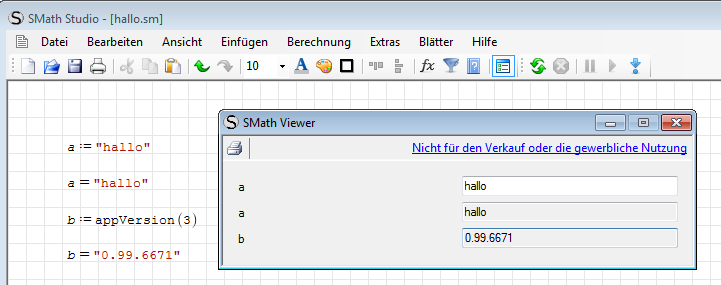

Can't reproduce
hallo.sm (2.75 KiB)已下载 1190 次。
hallo.zip (482.23 KiB)已下载 424 次。
#8 已发布: 2018/7/2 11:11:51
Arie
Arie
94个赞,共285个帖子。
Martin,
Once the Viewer is running try to change the value of Hallo and notice if it doesn't update in the second box.

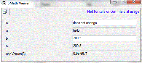

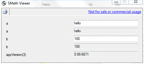

For me it works. Yet I have to press enter to forward the changes in the input box.
#11 已发布: 2018/7/3 06:14:27
325个赞和1个踩,共2,052个帖子。
For me it will change the numerical variable but not the string one (with return pressing, of course).

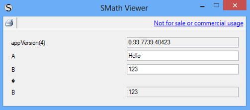

26个赞,共155个帖子。
Seems to be working just fine for me.
99.7739.40423_Test_exe.zip (571.28 KiB)已下载 395 次。
Good Luck!

#20 已发布: 2021/3/12 23:29:48
1,139个赞,共1,805个帖子。
I'm using 64bit Win10 Enterprise by the way. Maybe it matters?
Me too, but 32 bits. I'm reinstall SMath and now works fine.
Thanks.
