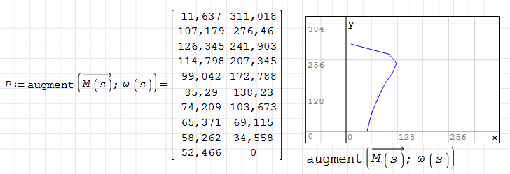

#5 已发布: 2023/2/15 03:57:36
1,362个赞,共2,276个帖子。
TopUser2000 2023/2/15 04:33:00
#6 已发布: 2023/2/15 04:39:21
TopUser2000
TopUser2000
0个赞,共28个帖子。
Oh, thanks friend). That's what I need.
can someone explain to me why I have to use a vector quantity when outputting the value of M(s)? Otherwise, Smath complains about a non-square matrix.
And can I rename the axes on the graph? Write ω instead of Y, and write M instead of X?
#7 已发布: 2023/2/15 06:10:42
1,362个赞,共2,276个帖子。
The vectorize function enforces elementwise operation if vector valued variables are involved.
The linear operation defining omega is elementwise by default, whereas dividing by s would be understood as a matrix operation (inversion) by default.
Modifying axes labels is only possible in other plot regions like X-Y plot plugin.

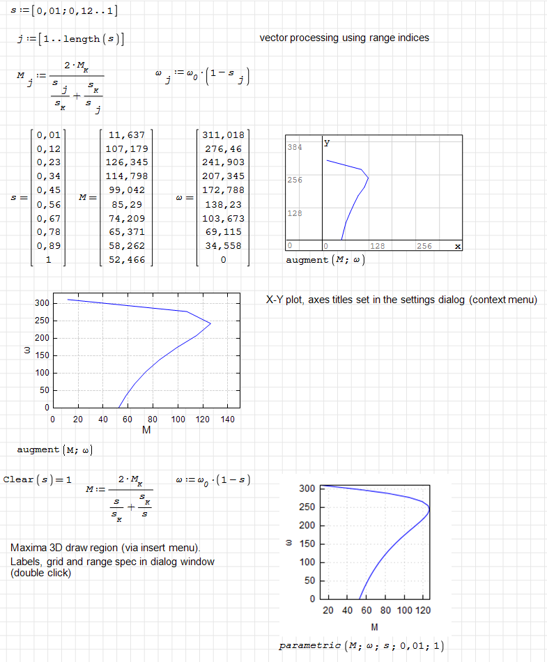

#12 已发布: 2023/2/16 17:55:33
1,362个赞,共2,276个帖子。
Vectorize-free versions, one with range indices and one with parametric plot.
1_Kr.sm (30.92 KiB)已下载 1336 次。
