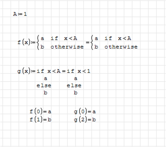

Shouldn't the variable A be replaced by its value 1 when 'cases' is used instead of 'if/else'?
Whatever is behind the scene, your project is ill posed..
Conditional statements must be intelligible for the numerical maths.

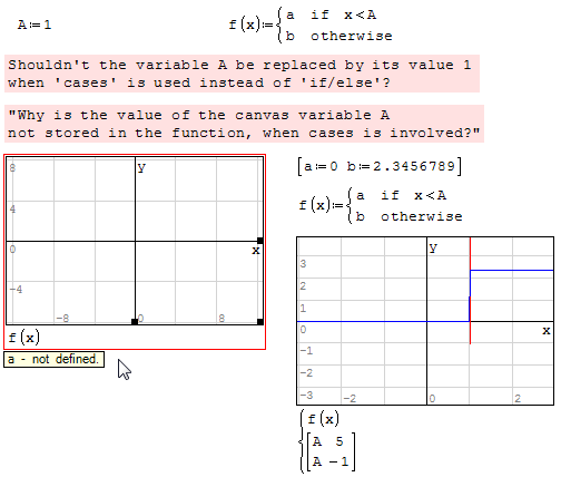

I really don't want to play silly games with you anymore.
I asked a simple question: "Why is the value of the canvas variable A not stored in the function, when cases is involved?"
Your answer has absolutely nothing to do with my question.
I have attended another screenshot to show the consequences of not storing the value.
cases behaves, as if there where a line operator.

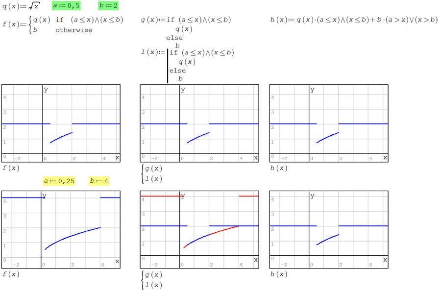

I think I can remember that in the past when "hovering the mouse" it was was dissolved in a chain (product) of boolean expressions, without using if/else.
Yes, It looks like that may have changed about two years ago according to this post: https://en.smath.info/forum/yaf_postsm35489_Custom-Functions-plugin.aspx#post35489
Which leads me to believe the cases() functions worked different depending on the optimization.
You can see source code here: https://smath.info:8443/!/#public/view/head/plugins/CustomFunctions/SMathFunctions/Programming/cases.cs
I'm not well versed enough in plugin creation to know how this is handled with different optimizations.

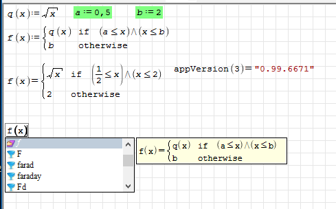

The values of a, b and q(x) are not stored in f, as you can see in the following screenshot.

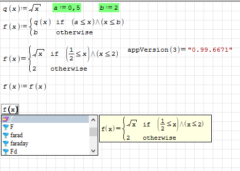

And by assigning f to f they are!
And that seems to me like a kind of invisible line operator, because it behaves like one.

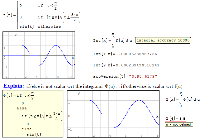

The all thing is about what comes from conditional.
For instance: the integration operator needs an analytical integrand.
From if/else, integrand is not scalar vs if/Otherwise.
Simple things turn nightmare ... many same in Mathcad.
Plots are same but not integration.
#17 已发布: 2018/4/30 20:14:58
983个赞,共6,866个帖子。
... for this particular integration example, it is necessary and sufficeinet
to transform the domain of if/else [ infinitesimal ...] in scalar domain.
Here, we have it already done in term of integration.
Integrate Discontinuous [Nuance].sm (13.02 KiB)已下载 1007 次。
So I believe I understand what is going on a little better.
I've attached the same .sm file as before only this time with break points. If you open the debugger window and step through you can see exactly what happens.
When f(x) is defined it sets f(x) equal to cases(a,xNote when g(x) is defined it will step through and evaluate the if() function and each individual input parameter (xThe cases() function within f(x) doesn't actually evaluate until it is called with f(0).
This is why, as you described earlier, if you set f(x):=f(x) you finally get the result that you want, because at this point it will finally evaluate cases(a,x
I'm not sure if this is a plugin issue or if this is just how SMath handles it's plugin interface.
