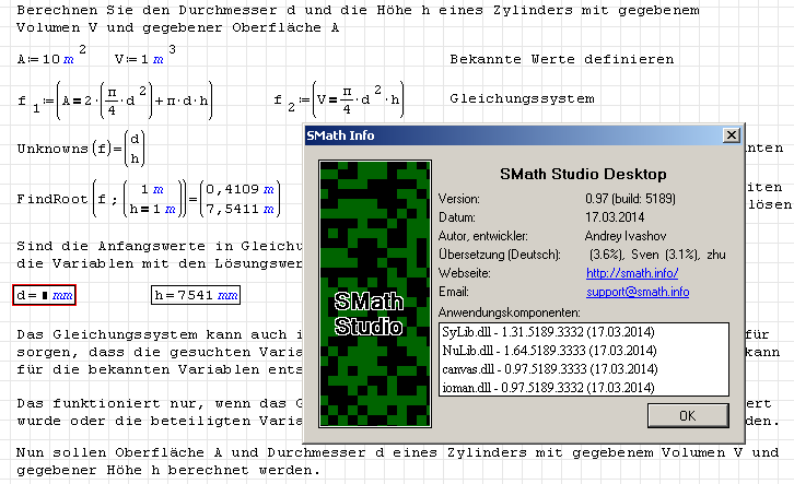

By the way Martin,
I might missed it, but I think there is still no answer about the differences between the official (wrong) and unofficial-portable (correct) and FindRoot() example
#5 已发布: 2014/5/3 07:56:06
1,362个赞,共2,276个帖子。
Can't reproduce this. Based on 0.97.5189 there is no difference between portable and non-portable version.
#6 已发布: 2014/5/3 09:31:29
325个赞和1个踩,共2,052个帖子。
This is quite strange . Could someone else else try to reproduce this please.
This is only happening to me with the official (regular) install
#7 已发布: 2014/5/3 10:18:48
1,443个赞,共2,936个帖子。
NS version is 1.0.9999.5 for both of you (Martin and Radovan)?
#8 已发布: 2014/5/3 10:24:19
1,362个赞,共2,276个帖子。
I confirm version 1.0.9999.5 according to plugin dir name. I also tried to change arg/dec sep settings to komma/period and get the same (correct) result.
Davide Carpi 2014/5/3 10:25:00
#9 已发布: 2014/5/3 11:13:12
Hello Davide,
I also confirm the plugin version - see the picture please.
BTW, this is the same on my both computers home-Win7 32bit, office-Win7 64bit
Davide Carpi 2014/5/3 11:14:00
