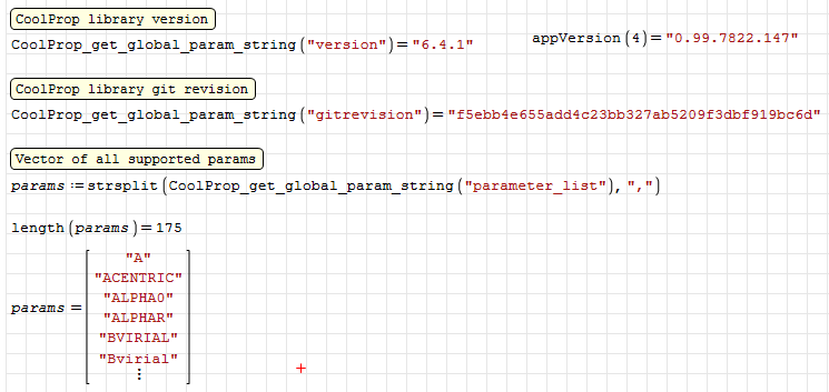

- CoolProp library updated to 6.4.1;
- refactored.

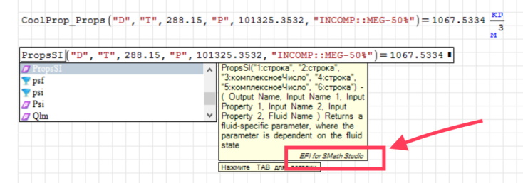

I am now getting the following error when using the CoolProp incompressible fluids library call
Initialize failed for backend: "?", fluid: "INCOMP::MEG-50%" fractions "[1.0000000 ]"; error: key [INCOMP::MEG-50%] was not found in string_to_index_map in JSONFluidLibrary : PropsSI("D","T",288.15,"P",101325.3532,"INCOMP::MEG-50%" )
This call was working March of this year. Any suggestions on what may be causing this issue?
Using:
CoolProp Wrapper Plugin 6.1.7713.14622
Smath Version: Smath Studio Desktop 64-bit, 0.99 (build: 7822)
CoolProp Version: CoolProp_v6.4.1.0
#51 已发布: 2021/6/25 06:53:31
1,558个赞,共1,868个帖子。
PropsSI() function is from another plugin (mcadefi + mathcad coolprop lib).
