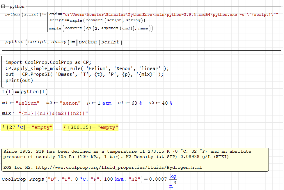

How can I get properties of mixtures e.g
CoolProp_Props("Dmass","T",273+100,"P",101.3*10^3,"Helium[0.5]&Xenon[0.5]"
ref: http://www.coolprop.org/fluid_properties/Mixtures.html
This can't be done directly in the current version of the plugin. It is not clear how to call the apply_simple_mixing_rule() function from the library, it can't be imported as it is not in the export table.
Click to enlarge
Click to enlarge
maple-python-coolprop.sm (6.61 KiB) downloaded 1543 time(s).
maple-python-coolprop.pdf (19.18 KiB) downloaded 997 time(s).
Click to enlarge
maple-python-coolprop-2.sm (5.08 KiB) downloaded 1517 time(s).

#63 Posted: 2023/4/22 05:34:44
1,544 likes in 1,859 posts.
More simple
Click to enlarge Click to enlarge Click to enlarge
maple-python-coolprop-3.sm (10.97 KiB) downloaded 1498 time(s).
maple-python-coolprop-3.1.sm (10.82 KiB) downloaded 1493 time(s).
maple-python-coolprop-3.2.sm (10.89 KiB) downloaded 1420 time(s).

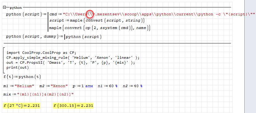

#68 Posted: 2023/5/4 10:29:17
Without "pyfile" (inline multiline script). The script should be without comments.
Space padding is necessary here so that inside the script, when a large string is divided into parts, the line break character itself is not divided ( '\n' -> '\ n' ).
maple-python-coolprop-3.7.sm (9.9 KiB) downloaded 1492 time(s).
maple-python-coolprop-3.8.sm (6.84 KiB) downloaded 1504 time(s).
maple-python-coolprop-3.9.sm (8 KiB) downloaded 1456 time(s).

#71 Posted: 2023/7/31 03:45:32
You should use a double slash for the full path.
I event tried environmental variables under Win10 but didn't work
In this case, you need to check whether python is available from the command line. If not, it means that the paths are specified incorrectly.

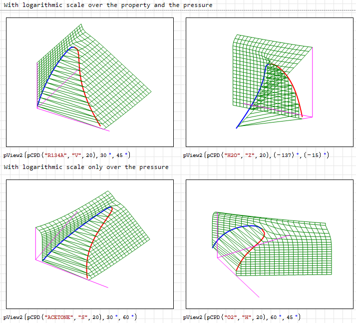

#75 Posted: 2023/8/8 02:01:18
1,106 likes in 1,784 posts.
Phase diagrams with CoolProps.
Click to enlarge
PhaseDiagram.sm (39.17 KiB) downloaded 1487 time(s).

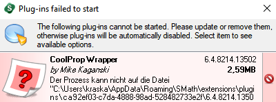

#78 Posted: 2024/4/16 03:55:20
1,353 likes in 2,264 posts.
It seems that multiple instances of SMath can't use the plugin at the same time.
How to reproduce:
1. Open SMath and access any Coolprop function
2. Open another SMath instance: You get an error message

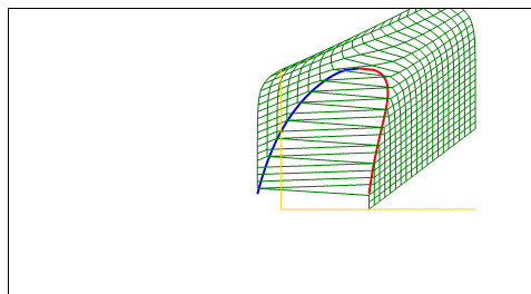

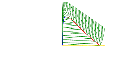

#79 Posted: 2025/12/19 01:10:36
Phase diagrams with CoolProps. ...
Now can show other thermo properties, and get animations.
PhaseDiagram.sm (46.88 KiB) downloaded 481 time(s).
Animating volume of water and enthalpy of O2.
