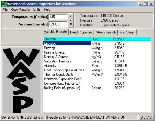

The user also asked for speed of sound and isentropic exponent functions. Is there a way to help him?
"WASP" is freeware for 10 minutes use, unlimited sessions.
"WASP" from "Katmar". all properties are tabulated per T(°C) or P(abs).

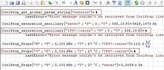

CoolProp_get_global_param_string("version"
lastError="Error message couldn't be retrieved from CoolProp library (buffer size issue?); the second try returned: "
what's the problem?

There may be two issues:
1. WASP is awfully involved in Basic construction. I coded it in Mathcad 11
Get the Katmar WASP [very complete] free for 2 min session, unlimited sessions.
2. The published Basic is unitless, the CoolProp is unit based,
that is enough to freaked the codes. The Mathcad version from Valery was OK.
Sorry, can't help more.

Error:
which versions of SMath and CoolProp plugin are you using?
version SMath - 0.98(build 6484)
version CoolProp -
I'm try on the various Windows platforms (32/64):
good result on
Win10x64Pro, Win7x64Ultim
don't working on
Win10x86Pro, Win10x86Educ, Win7x86Pro
Best regards,
Aleksey

don't working on
Thank you, reproduced. Something goes wrong with the wrapped 32 bit library (the coolprop dll returns both the correct result as well as an error code, hence the errors shown).
