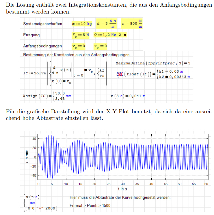

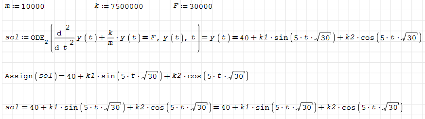

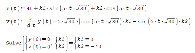

SMath Forum SMath Studio Questions How to apply initial conditions in second-order differential equations 1 Pages (3 items) How to apply initial conditions in second-order differential equations - How to apply initial conditions in second-order differential equations - Messages Go to last post #1 Posted: 2025/12/7 03:59:55 kimkim 0 likes in 9 posts. Group: User How to apply initial conditions in second-order differential equationsThe solution to the second-order differential equation has been obtained as follows.If we want to find the solution by applying the initial conditions y(t)=0, y'(t)=0,what should I do in the following steps?thank you for your help. Edited 2025/12/7 06:53:24 #2 Posted: 2025/12/7 09:07:00 StvMath 44 likes and 1 dislikes in 71 posts. Group: User Once you've got y(t) you could simply do the following: 1 users liked this postkimkim 2025/12/7 21:41:13 #3 Posted: 2025/12/7 12:54:45 Martin Kraska 1,353 likes in 2,264 posts. Group: Moderator If you don't need the function v(t), you can specify the initial conditions directly: (example 10.2 in https://github.com/sn-code-inside/Technische-Mechanik-mit-SMath) Technische Mechanik mit SMath Studio: https://link.springer.com/book/10.1007/978-3-658-50592-9 3 users liked this postsergio 2025/12/7 17:07:45, kimkim 2025/12/7 21:41:18, ioan92 2025/12/9 10:52:27 1 Pages (3 items) New Posts No New Posts
