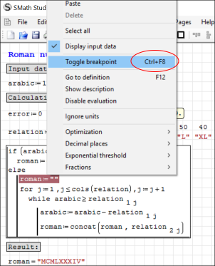

What does this refer to:
"Shortcut key added to Toggle Breakpoint context menu item"
Thanks!
#3 Posted: 2016/8/20 04:46:17
2,326 likes in 4,013 posts.
Sure. Screenshot added above.
