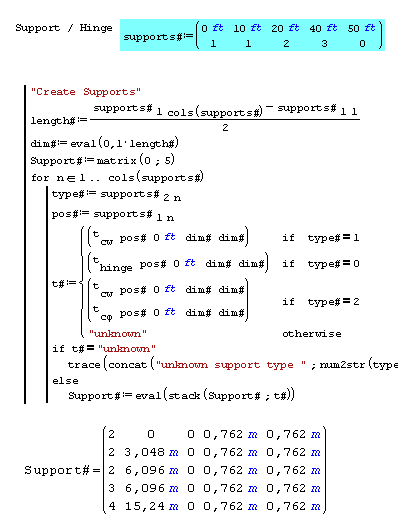

Attached is a deconstructed version of the preprocessor with notes
Modeller output
What does the 8th column represent?
What is "sym" template?Does it create a beam that is symmetric about that line or is it a 'fixed' support (i.e. fixed against rotation)?
What is the difference between t.hinge and t.cφ ?
In t.cw and tcφ what does the 'c' stand for?

8th column of the modeler output is a unique object ID
template sym represents a constraint phi=0, i.e. no rotation but free displacement. This is equivalent to a symmetry constraint or can be used together with a displacement constraint w=w.0 to make an encastre condition (built-in)
t.hinge is the template number of the hinge symbol (circle)
t.cphi is the template number of the constraint phi=0 symbol. The c stands for constraint (as the description string tries to say)

How do you recognize when you have nested symbolic expressions? I'm missing something here, it just isn't 'clicking'.
So if you want a built in constraint (i.e. Fixed), you would have a support (aka t.cw) and sym (aka t.cphi) at the same 'x' location (and thus the same node), correct?

One example for nested expressions is if you build a matrix in a loop with stack(), then no intermediate simplification is made, except if you apply eval().
You are right in how to make a fixed constraint. If you want to convey global parameters in a clean way, you might setup a list or vector of key=value pairs, hand that over as a regular input argument and evaluate them inside the function using Assign(). Didn't test this, but it might work.
If you by some reason don't like output arguments, then feel free to modify the functions accordingly. I feel it a bit cumbersime to extract the individual result items to new variables by individual assignment operations. But you are right, I could create a system of equations and apply Assign() to it.

What is the best way to implement this. For some reason I can't seem grasp the best way to insert or remove rows from matrices (which is a big problem for most programs!)...
If I understand correctly the FEM beam function... to create a "Fixed" support I need to have a t.cw and a t.cphi at the same position. Therefore I need to create a new matrix with an extra support "type" at the same position. What is the best way to do this? See attached for portion of the routine that I am referring to.
Thanks!
Thanks!

Thank you Martin!
Well here it is. Not sure how stable it is as I have only limited testing. I wish the graph was easier to move around.
