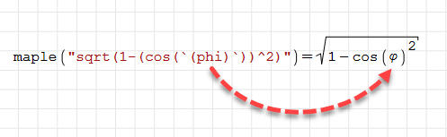

is this solution correct?
is this solution correct? - 消息

#2 已发布: 2023/6/8 23:35:04
1,139个赞,共1,805个帖子。
Obviously not, but the bug isn't that obvious: just avoid to use that 'phi' (j Ctrl-G):

#3 已发布: 2023/6/9 08:08:11
983个赞,共6,866个帖子。
Is this solution correct ?
As given, your function is plain/native. Nothing else applies.
Cheers ... Jean.

#5 已发布: 2023/6/9 09:07:42
1,558个赞,共1,868个帖子。
Yes, these are different letters:
cos(ϕ) and cos(φ)
maple() works with φ
This was done to unambiguously convert variables into Greek letters:
maple() function uses implicit encoding of Greek letters:
churichuro 2023/6/9 15:32:00

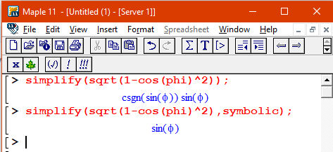

#6 已发布: 2023/6/9 11:58:48
1,139个赞,共1,805个帖子。
I think the result soomoon expects is this, but it requires a newer version of maple:
where can i get a new version of maple ?
#8 已发布: 2023/6/12 11:12:20
1,139个赞,共1,805个帖子。
Inside SMath, you can't. This is a workaround, valid for real values
