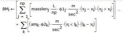

Sum over 'n' ... NOT over 'k'

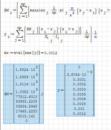

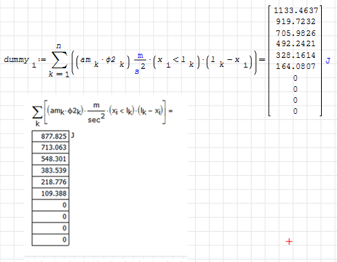

Model summation attached.
Function Running Summation.sm (32.66 KiB) downloaded 1062 time(s).

Hi. As Viacheslav says, it's better in this case the mathcad file. Just a couple of notes.

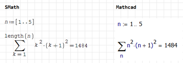

You use a for loop with i as counter. Thus, at the exit, i equals the last count value, not the entire range. So, or you redefine i as range, or use this way for not changing i value
Actually, SMath doesn't have "range" variables, it only have scalars and matrices. But mathcad have "true" range variables, which it's more a complication than an adventage. BTW in SMath you can't use a range variable in the same way, and sometimes needs some dummy variable for detect them
Finally, remember that in mathcad sqrt(-1) is 1i, but in SMath it is just i, so using is as counter you loose all the complex algebra.
Bests regards.
Bests regards.

The A,B are numerical two vectors of coefficients.
Then introduced in the scalar function wrt sin/cos.
