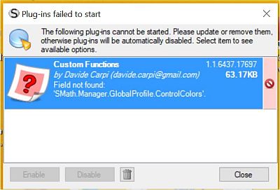

I am experiencing problem in installing CustomFunctions Plugin in SS 6520 (07/11/2017).
Even some items {(such as cases(), abs()}in the Function Index of Reference book have problems.
I am using Win 10 64 bit latest update.
Pl test the attached example.

#2 Posted: 2017/11/8 09:37:35
Confirmed as well,

#3 Posted: 2017/11/8 15:49:41
1,441 likes in 2,932 posts.
Thank you, I'll fix it ASAP. As usual please be patient and keep reporting issues

#5 Posted: 2017/11/9 11:45:13
NDTM Amarasekera
NDTM Amarasekera
130 likes in 352 posts.
Thanks David. Following Screenshots(SC) are taken before updating Custom Functions Plugin.
SC 1: Selected Function Index of Reference Book.
SC 2: abs() selected and before updating Custom Functions.
I will let you know the situation after updating Custom Functions.
