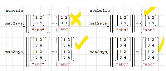

22个赞,共84个帖子。
The function mat2sys.1 affects also the inner matrix, if evaluated numerically AND if this inner matrix contains only element.
Is that really the intended behaviour?
I wanted to build my own mat2sys.1 using num2str, ... replace mat with sys... str2num
Looks like str2num is the "culprit", at least in my own function (only while evaluating numerically).
Maybe the better question is: Is this behaviour of str2num intended?

#126 已发布: 2021/5/31 12:13:07
1,443个赞,共2,936个帖子。
The behaviour is driven by the evaluation of the outer sys(); on numerical evaluation, the "first level" of 1x1 matrices is suppressed.
I'm not sure if it is really intended, but it might be part of the special behaviours of sys() (have to check the code/ask Andrey).
2位用户喜欢此帖子
NDTM Amarasekera 2021/5/31 12:29:00, Martin_B 2021/5/31 12:37:00
#127 已发布: 2021/5/31 13:02:53
Martin_B
Martin_B
22个赞,共84个帖子。
By now I think it's the general behaviour (intended or not), that 1×1 matrices are evaluated to its element (numeric).
That's why I use Gettype() to check if an element was found.

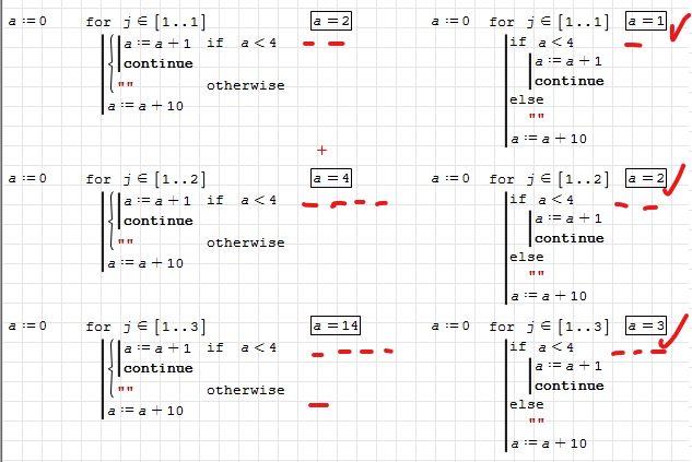

#128 已发布: 2021/6/9 09:49:05
Martin_B
Martin_B
22个赞,共84个帖子。
Found a bug in cases in combination with for loops and continue:
Two identical loops.
If if(,,) is used, continue causes the rest to be skipped (as expected).
If cases(,,) is used, continue has no effect
appVersion(4)="0.99.7822.147"

#130 已发布: 2021/6/15 03:19:03
600个赞,共1,381个帖子。
Confirmed, with a strange behavior.
Reversing the cases makes it correct.
#131 已发布: 2021/6/15 03:46:04
1,443个赞,共2,936个帖子。
At first glance I'm not sure about the cause, I'll check it.
However looking at the screenshot I have to point out once again that in general you shouldn't put definitions inside cases().
Unlike if(), when a condition or a case fails instead of throwing an error the whole function is returned like if doesn't exists. The consequence is that every argument is exposed and preprocessed, with potential unwanted behaviors respect to the expected logic. This is on the edge of SMath possibilities, but is what makes possible to use cases() whereas if() usually fails.

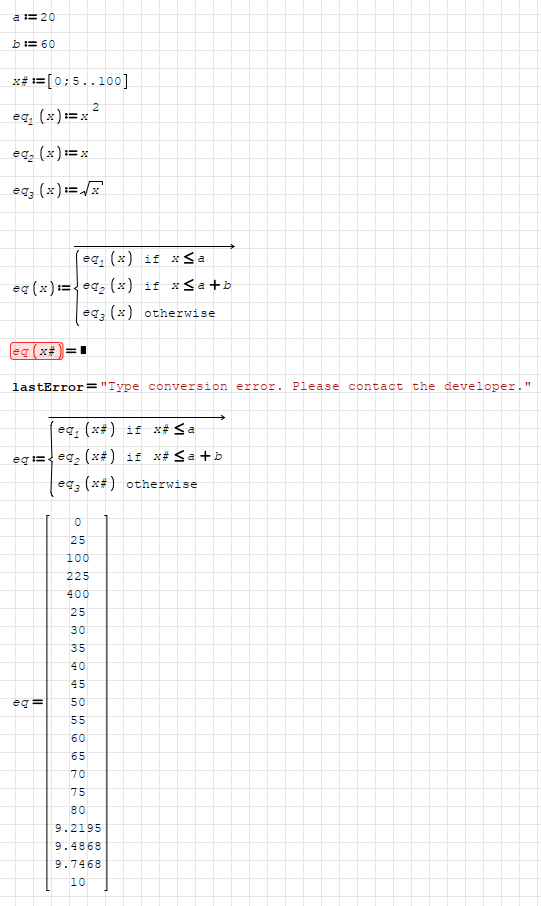

#138 已发布: 2025/8/29 09:50:08
1,362个赞,共2,276个帖子。
ClearAll() affects the built-in variable lasterror, depending on the argument provided. Yet, the description doesn't mention any significance of the argument and also promises not to touch pre-defined objects.
Oscar Campo 2025/8/29 10:03:44
#139 已发布: 2025/8/29 12:38:36
1,443个赞,共2,936个帖子。
Seems lastError is stored in the context, unlike other predefined variables. I'll add an exception.

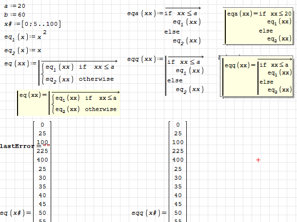

#140 已发布: 2025/9/11 09:51:54
1,362个赞,共2,276个帖子。
I think that we would need more brackets here in order to make the scope of the at() or the corresponding operator function visible.
