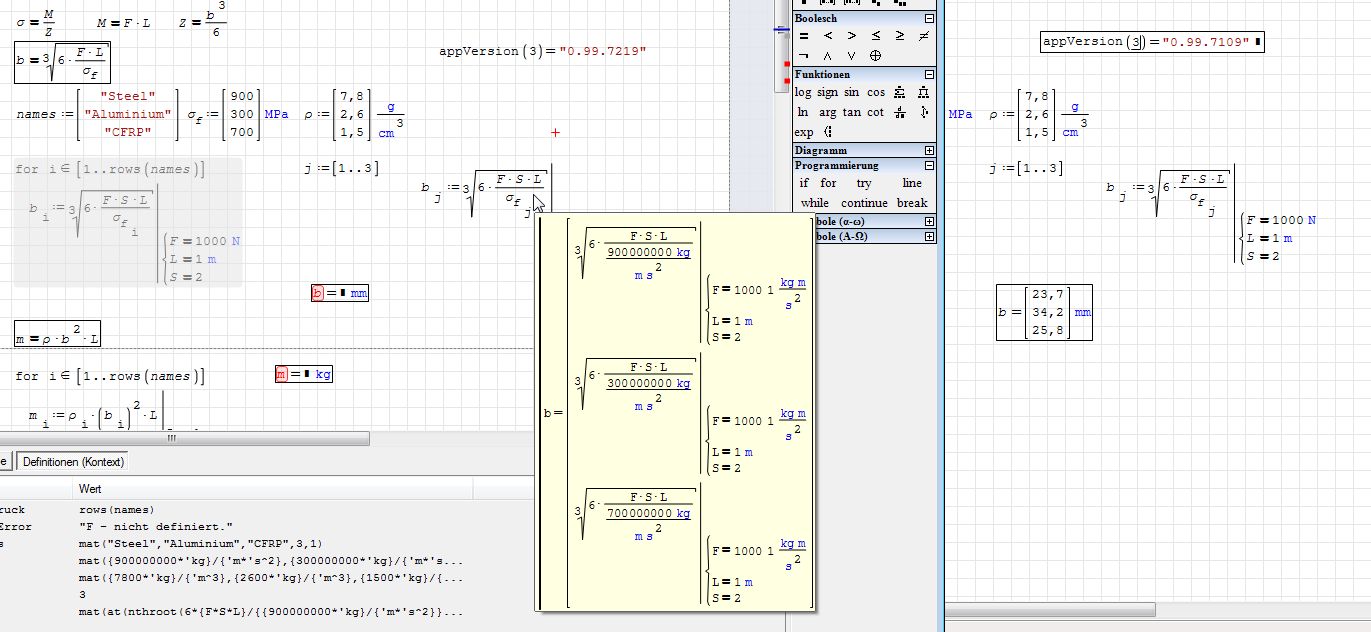

#103 已发布: 2019/10/29 07:50:37
1,362个赞,共2,276个帖子。
There is a problem with at() in build 7219:
It seems that the function at() isn't executed.
Materials E7-6.sm (10.32 KiB)已下载 1607 次。
显示剧透
#104 已发布: 2019/10/29 13:27:07
1,443个赞,共2,936个帖子。
Thank you Martin, I will look at it as soon as I can.
edit: fixed in later versions SS

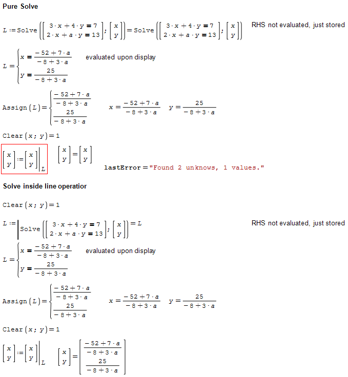

#105 已发布: 2019/11/3 09:18:28
1,362个赞,共2,276个帖子。
In the attached sheet, the conversion of solution results into definitions is demonstrated in two ways:
1. Usage of Assign(), a function made for this purpose in the Maxima plugin.
2. Usage of the substitution function at() from custom functions plugin, which by syntax should be good for the purpose.
It turns out that it makes a difference whether the Solve function is inside a line block or not. In the latter case, at() comes up with a strange error message.
Solve-3.sm (20.06 KiB)已下载 1617 次。

either this should works correctly now:
