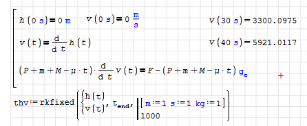

Error by ODEs solution
Error by ODEs solution - Help please - 消息
#1 已发布: 2023/12/14 01:35:18
Valery Ochkov
Valery Ochkov
67个赞,共716个帖子。
Here OK Rocket-1.sm (16.79 KiB)已下载 1443 次。
Here not OK Rocket-2.sm (688.11 KiB)已下载 1475 次。
About the problem Study-24-How-calculate-Rocket.doc (1.95 MiB)已下载 859 次。
from the book
https://www.routledge.com/25-Problems-for-STEM-Education/Ochkov/p/book/9780367345259

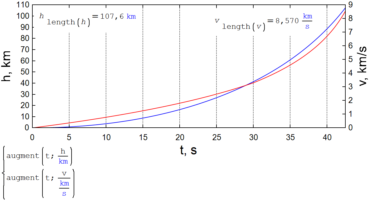

#2 已发布: 2023/12/14 09:58:26
1,139个赞,共1,805个帖子。

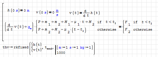

Hi Valery. Just use cases() instead if() clauses.
Rocket-2.sm (688.31 KiB)已下载 1517 次。
But Newton's second law is not F=ma which is an expression valid only for systems where m is constant. The general expression given by Newton is F=d(mv)/dt or F=dp/dt with p=mv the linear momentum.

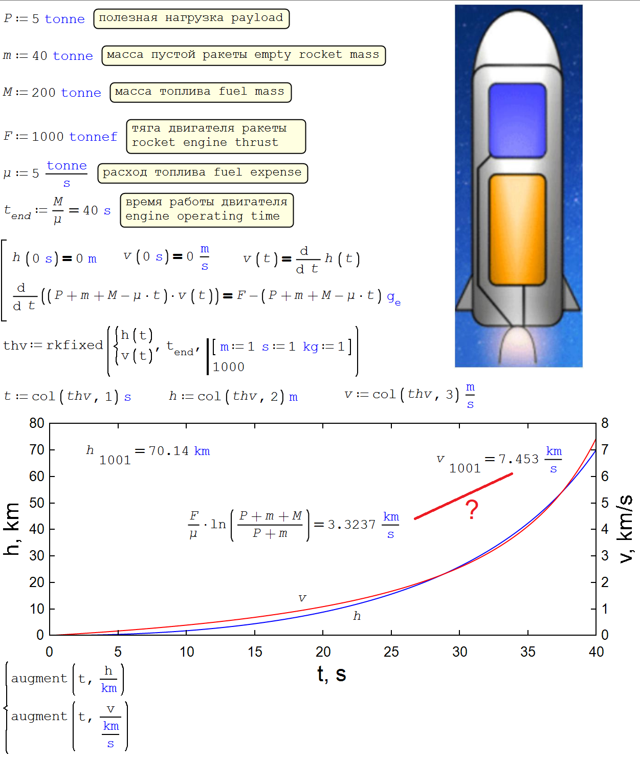

One questions.
How can we solve this problem with ODE as F=dp/dt, not F=m dv/dt?
Will we get others (numerical) answer?
Rocket-2-otherwise.sm (690.02 KiB)已下载 1497 次。

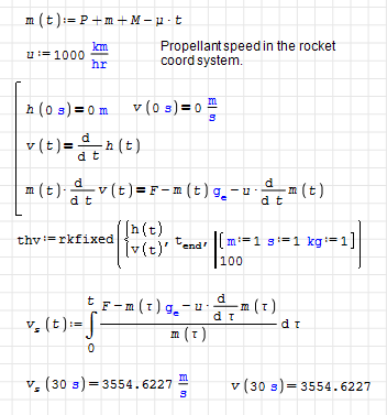

#4 已发布: 2023/12/14 18:32:10
1,139个赞,共1,805个帖子。

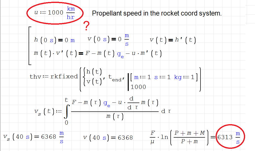

The speed of the rocket cannot be independent of the speed at which the propellant exits. Entering that information gives me this solution
Rocket-1.sm (20.07 KiB)已下载 1449 次。
Another way of looking at it, using the equation F = d(mv)/dt, we must take into account that in a rocket the reaction force is not applied to the same body as the action force, as the 3rd Law says, and therefore the temporal derivative of the product mv must be done by changing the reference frame, which is why it is F = m dv/dt + u dm/dt, where v is the speed of the rocket with respect to the inertial reference system attached to the earth, but u is the speed of the propellant with respect to the non-inertial reference system attached to the rocket

New question
Rocket-1.sm (734.95 KiB)已下载 1497 次。

Hi Valery. You can't take the temporal derivative directly. Please see my previous answer explaining why I think that.

#8 已发布: 2023/12/15 03:25:33
1,139个赞,共1,805个帖子。

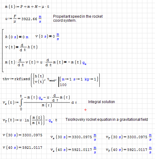

Hi Valery. You're right encircling u. Its correct value is u = F/μ. Thus, the force over the rocket is F = - mg - u*dm/dt
Rocket-1.sm (23.73 KiB)已下载 1484 次。

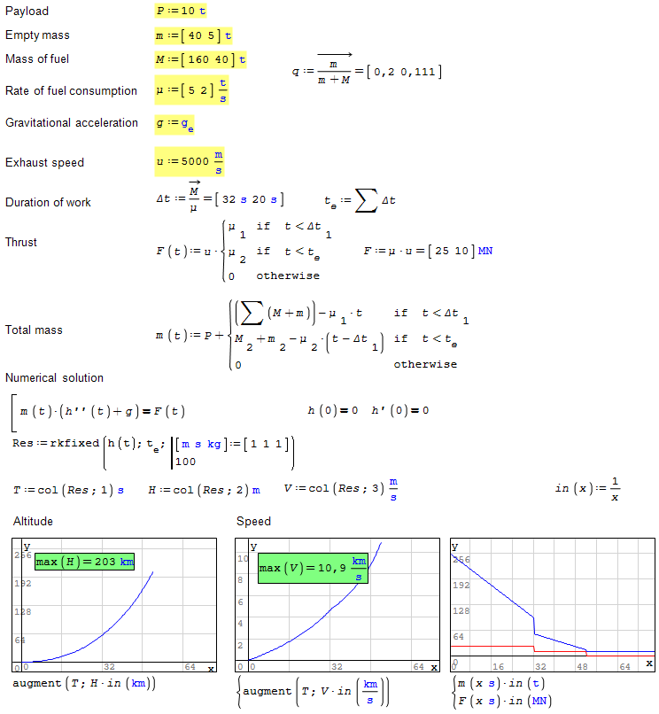

#9 已发布: 2023/12/15 04:04:15
Valery Ochkov
Valery Ochkov
67个赞,共716个帖子。
Thanks, Alvaro.
And what about the 2-stage rocket?
Our first try
Rocket-2.sm (690.02 KiB)已下载 1543 次。
#10 已发布: 2023/12/15 04:30:05
1,139个赞,共1,805个帖子。
Our first try
Hi. Your original solution for rocket-1 is ok, and that implies that the movie's solution is also ok.
I was only pointing out the way to deduce it. Writing the relationship for several stages would imply asking for derivatives for functions with cases(), which cannot be done, because although functions can be integrated with cases() or using inside the Mathcad block, they definitely cannot be derived.
So I guess the best solution is the one you gave at the beginning, simply replacing the if() with cases(). The deduction based on physical principles has already been done for one stage. Now it remains to apply the simplified result for several, which is exactly what the rocket-2 case does.

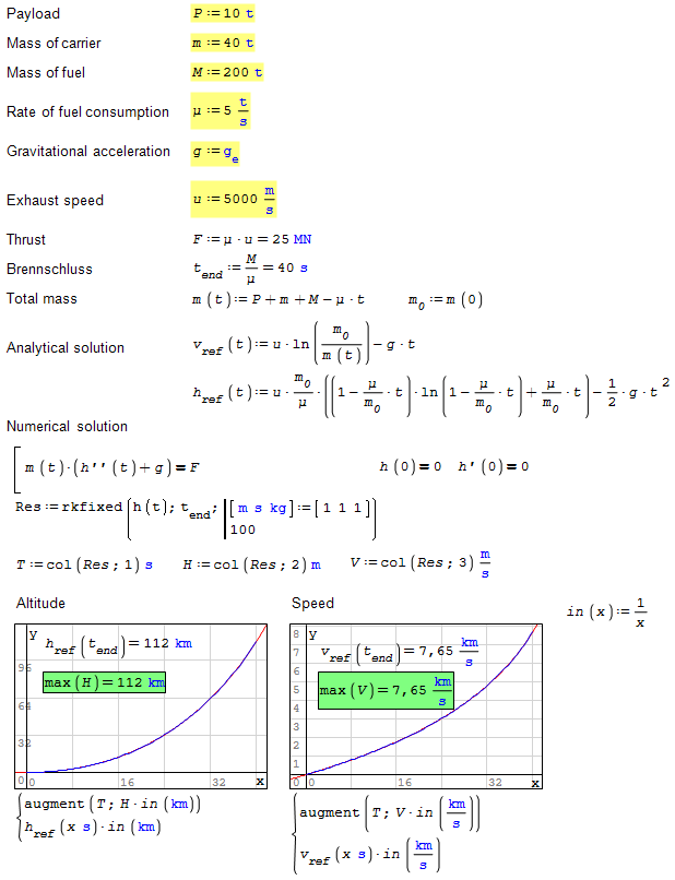

Analytical reference solution for h(t) (from a mechanics textbook) and with a single second order DE. in() would be even better without braces (operator form)
Rakete.sm (21.1 KiB)已下载 1469 次。
Rakete2.sm (21.45 KiB)已下载 1509 次。

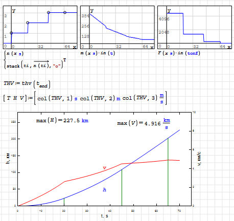

#20 已发布: 2023/12/18 07:35:01
1,139个赞,共1,805个帖子。

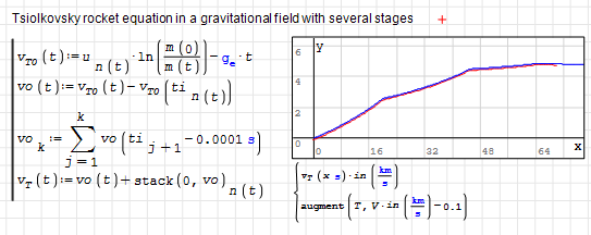

3 stages variation.
Checking with Tsiolkovsky rocket equation in a gravitational field with several stages
Rakete-3.sm (46.49 KiB)已下载 1510 次。
