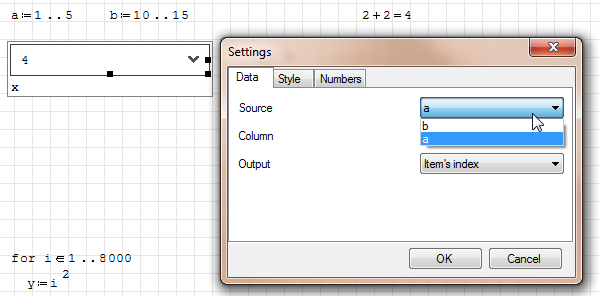

I mean changing the value of the "Source" parameter in the form
#9 已发布: 2014/8/6 06:36:19
1,362个赞,共2,276个帖子。
I defined another matrix d, switched the input to it and don't see any problem.
Davide Carpi 2014/8/6 07:44:00

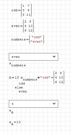

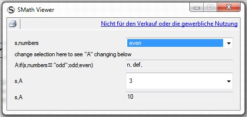

hello guys!
dear Davide Carpi,
as I've been using your very util plugin during
my tesis for the calculation of wooden joints,
I found out about a problem concerning the combined
use along with the Viewer.
It seems to me the once the Viewer loaded the file, all
the settings about the input variables for the comboboxList
are made. In the case, like you see in the example-pictures,
of multiple lists depending on their selection to decide
about the next-ones input, it comes to dificulties concerning
the update process.
The problem still consists with the newest version of SMath.
Is there a way to fix this problem?
I'd be glad aboud any advice of solution!
Thanks a lot!
Greetings,
Eckhard Bräuchler

#20 已发布: 2016/3/9 07:57:22
1,443个赞,共2,936个帖子。
Confirmed, I'll provide a fix ASAP.
