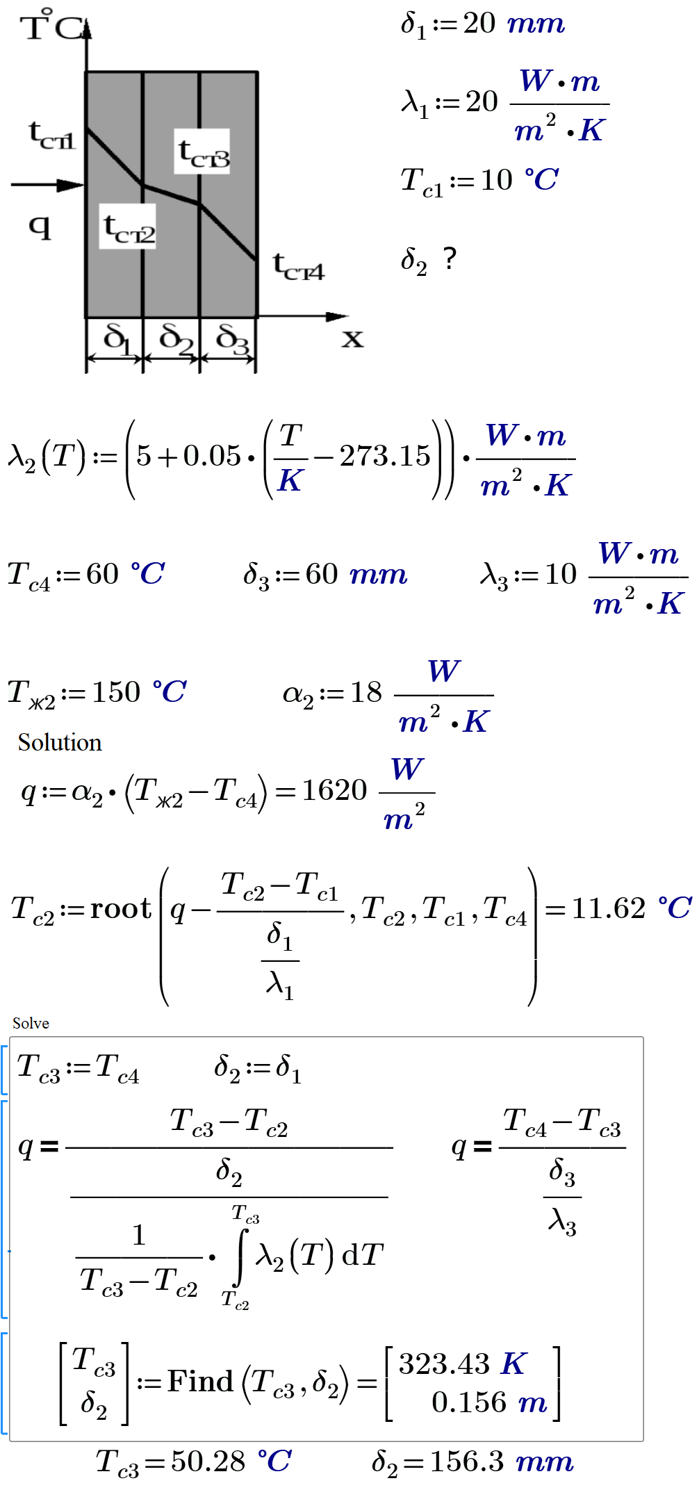

I can it solve in Mathcad - see please mcdx and pdf files
I try solve it (heat transfer) in SMath - see sm file
Help please

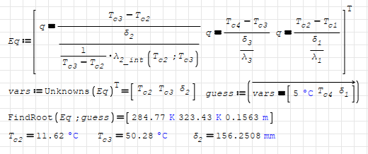

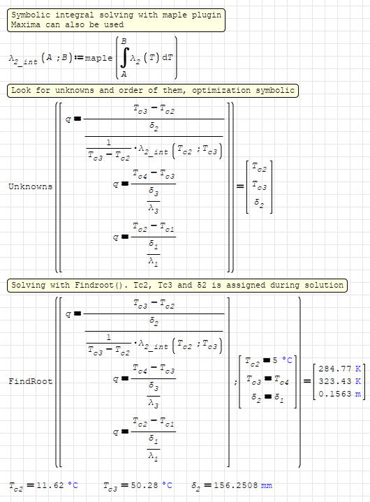

SMath symbolic solving of integration is not capable as Mathcad.
Thus integrals can't be used with numeric solvers.
However, you can use a little trick to solve them.
Using maple or maxima plugins is the key.
Here is your problem solved with various ways, roots() and Findroot().
solvewithunits.sm (23.4 KiB) downloaded 1123 time(s).
3 users liked this post

Actually, you don't need to find Tc2 first hand.
Findroot() can solve with all three equations at once.
All important is the order of unknowns.

#5 Posted: 2023/6/5 00:08:21
597 likes in 1,377 posts.
Here is a paper-friendly version.
Also check how variable guess points are assigned.
Valery Ochkov 2023/6/5 02:23:00

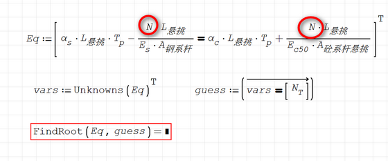

Please help, why can't find root for this simple equation?

netsonicyxf
netsonicyxf
2 likes in 79 posts.
Because there aren't unknows
Thanks Davide.
Now I put "N" as unknown in the Eq. But it can't be solved either.
root.sm (19.41 KiB) downloaded 1074 time(s).

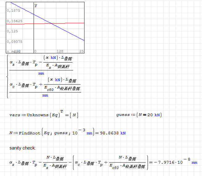

#14 Posted: 2023/6/26 10:58:58
1,441 likes in 2,932 posts.
You have to play a little with the precision, especially if there are units involved; in this case, seems that 10^-3 mm is a stable target (10^-2 works too, but in some case it returns the guess value, meaning that is "close enough" for the algorithm - you can see in the plot that 0kN to 200kN is in +0.02/-0.02mm range)
root_r1.sm (24.03 KiB) downloaded 1110 time(s).
