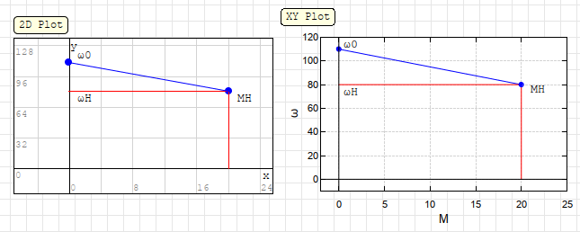

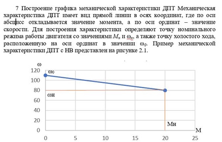

Hello.
Tell me, please, if I have two points, then how can I plot a graph between them? According to my assignment, I need to build several graphs, but I do not know how to do it in the program. I have done the calculations, but for the rest I ask for help from local experts. I attach a sheet with the task and a file with calculations (sorry, that's in Russian). Can someone help me figure it out here?

I made a sample with two different plots.
You can use them by changing variables.
DPT_NV plot.sm (11.08 KiB) downloaded 1061 time(s).

You can also use line and polyline commands for plot.
They work only in XYPlot, but sometimes they make everything easy.
There is also a setprop() function.
It can change format of your XYPlot automatically.
Search setprop() in forum for further information.

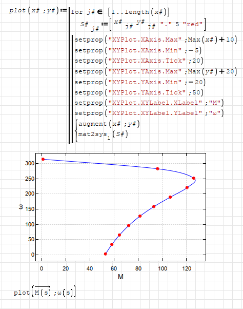

One more question:
if I have a graph (attached file), then how do I mark the points along which it passes?
I tried: vector M(s) ω(s) "." 15 "blue"
but the application immediately crashes.
AD.sm (20.17 KiB) downloaded 1021 time(s).
Is it possible to make the graph automatically scale to the new values?
And does someone use android version of Smath (from this site)? I can't edit any of these files there.

WroteIf I have a graph (attached file), then how do I mark the points along which it passes?
As in the attached.
Instead of re-scaling the same graph, plots all new graph on the same plot.
You will scale to accommodate for the larger graph.
AD Plot Points.sm (104.39 KiB) downloaded 1100 time(s).

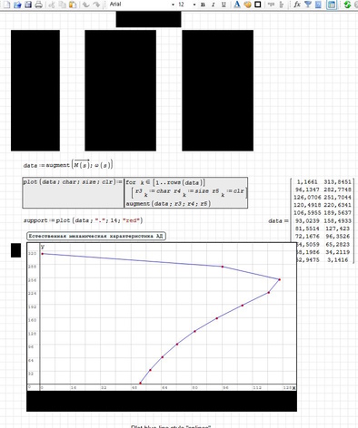

TopUser2000 2023/2/27 15:08:00
WroteIs there any simple way to add the pass points and autoscale a graph?
Some Smath versions decided that opening in other versions will be black.
1. Open this document
2. If black, select by groups, click on background white
3. Make the all document as per 2. directive
4. at this point, you have recovered my original
5. Plot points and more advanced.
AD Plot Points TopUser2000.sm (87.24 KiB) downloaded 1030 time(s).

You can use this, XYPlot region is suitable.
One custom function to plot everything.
It also autoscale the graph.
AD.sm (28.23 KiB) downloaded 1017 time(s).

Oh... What literature can I read about making plots in ?
Download first document @ post 10 ... let's see if it works ?
Now it works but anyway this way is too difficult for me
WroteNow it works but anyway this way is too difficult for me
Glad it works from doctoring the black.
Nothing is too difficult for Smath Community to which you now belongs.
Your very first document, populate more for standard reference project.
