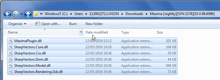

Hi Martin
have seen your post about the method to make it work again Maxima in the latest Smath release ( see herewith an excerpt ) even if with limitations in some functions .
"Next action: Test Maxima Plugin
- tools> Plugins> Interactive books> online gallery, download Interactive SMath Handbook, check use by default. Press "open"
- Launch interactive handbook: [?] Plugins, in plugins page follow link to plugin dir (green button next to plugin name (Maxima)
- Close SMath (otherwise you can't remove the Maxima dll in the plugin dir)
- Exchange contents of the single subdirectory by the contents of SVN 2175 version (see SS 2347
- Start SMath "
One thing that is not clear to me ( I apologize in advance for the elementary question ) is the 4th sentence " -Exchange contents of the single subdirectory...and so on", of which directory are you referring to ?
Hope that doing so I am at least able to do same elementary Symbolic determinants.
Franco

Martin
just as a last clarifications , the other dll's - the SharpVectors.xxxx' ones - that are in the SVN2178 shouldn't be considered for addressing the Maxima issue
Franco
