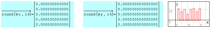

#246 Опубликовано: 13.02.2019 12:37:26
but solved correctly
Interesting to know SNRxy(a,N,εx,εy) works fine in your latest SS version.
Two pieces of code SS 6179 does not digest [@ big arrow].
FindRoot works fine manual patience, but could not make work in forloop.
As done, it saturates @ 12 decimals with the two degree of freedom.
I have done my best for myself if any useful for more visitors.
I could see some Matlab code wrt matrices A,B but does explain where
they come from. Still missing some abstract for readers.
Thanks Radovan, Alvaro ... most appreciated.
In short => SS 6179 does not cut the mustard ! a British expression.
Project Solve Flashing Copy.sm (204,07 КиБ) скачан 1713 раз(а).

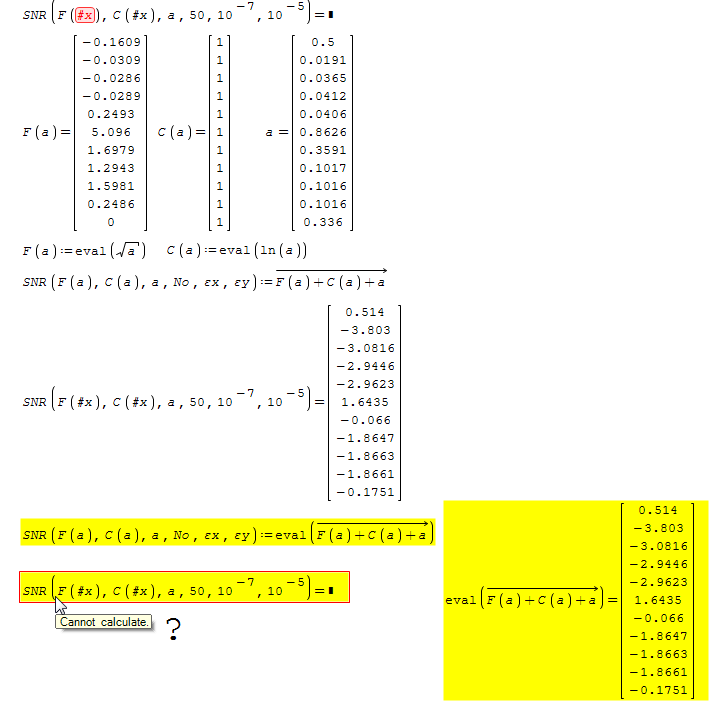

Hi. The troubles that I find solving this is that can't use the normal call for functions, as it is showed at the end, where fails to call the same Newton-Raphson code, but with F(1) and C(1).
This must to be some kind of bug calling functions when the definition of the functions it's complicate or implies the vectorization for the args.
Primer38-undoomed - redoomed.sm (75,78 КиБ) скачан 1671 раз(а).

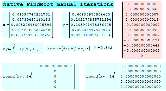

The "redooomed" downloaded but can't open yet. It might suffer same
auto-consumption than FindRoot, i.e: it does not clear itself within a for loop.
It must be called from an external forloop. Will post soon a semi-elegant way
of descending the FindRoot that needs several iterations as it is ± 3 decimals
from the Smath native module. I get 0.0000000000001 as final sanity solutions.
Takes ~ 5 minutes of manual iterations ... Jean is happy !
Cheers Alvaro.
#250 Опубликовано: 14.02.2019 00:44:31
It seems that I am repeating myself periodically.
Like when you start speaking to yourself, indicates the Man is in good growing conditions.
That version is refreshed in 8 manual iterations, easy to use.
Start by the very initials [xo, yo]
Project Solve Flashing Copy.sm (209,05 КиБ) скачан 1674 раз(а).
Thank you Alvaro for this. This was a logical thing to do in order to improve your function. Moreover, the "spooky" thing "xx-not defined" appears here and there and I often do not have a clue why. It often appears when you want to use eval(). Someone might have an explanation for this effect you represented in this example, but it still makes me confused and it seems it will remain that way. I suppose you understand now why I called this one as "doomed".

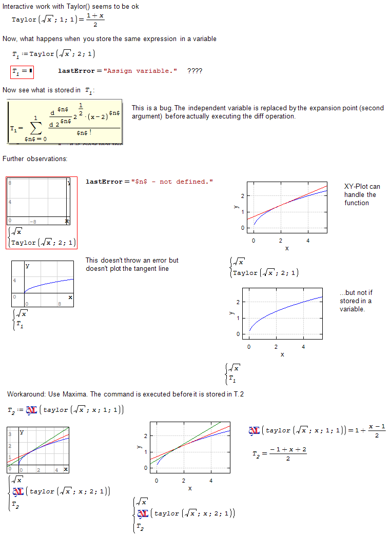

#253 Опубликовано: 29.01.2020 11:59:54
In build 7251, there is a problem with Taylor(), see screenshot. Bugreport filed as SS-4631
Taylor.sm (21,59 КиБ) скачан 1601 раз(а).

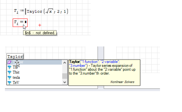

I encountered the bug as well in the latest version (build 8253) with plugin version 1.1.7097.23301, and as far as I can see, the latest update is from 2019: https://en.smath.com/view/618b7e96-330a-406a-b055-9e577672f0b8/summary
Is this plugin still being maintained, or should I look for another solution?
Thanks in advance!

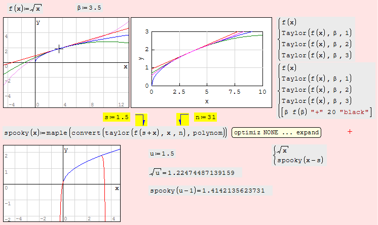

#258 Опубликовано: 20.09.2022 10:18:18
As far as Taylor is concerned, there is no bug in Smath.
Taylor is not a function. Simply a Classroom quick plot demo.
What it plots is not otherwise possible to evaluate.
However, you can play/productive with the spooky Taylor.
Cheers ... Jean ... hope it clarifies.

#260 Опубликовано: 21.09.2022 11:58:53
The missing document.
Maths Taylor Spooky.sm (20,43 КиБ) скачан 1651 раз(а).
